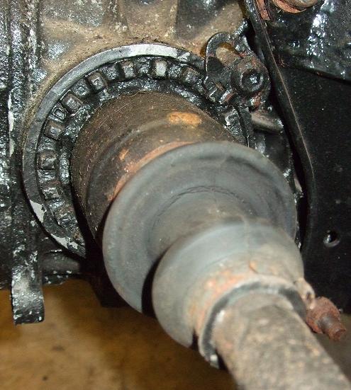

Hi Paul,
Yes they do!! Obviously you will need to dismantle the driven wheel side to enable it to do this.
John
Some do and some don't. If it has drums then chances are they do. If it has discs it'll have the Lobro style shafts and you will see a row of torx or allen bolt heads around the driveshaft - if they are there you need to undo those at both ends and the shaft can be removed. There are a very small number of cars with drums and Lobro shafts (I've only ever seen one in the flesh and pictures of two others) These are the same as disc setups from the point of view of removing the drive-shafts. It's also possible to construct a mongrel driveshaft with the Lobro joint on one end and the push in joint on the other end (usually done to use a limited slip diff with drum brakes) - obviously in this case one end pushes in whilst the other un-bolts.

Thanks for that, i do have drums, so my next question should these be easy to pull out ? if so mind aren't.
Will i need to use a slide hammer?
Paul
Guest smartfazer
Providing you have undone/removed the drums, backplates and hubs from the trailing arm, then yes they should fairly easily just pull out.

Thanks for all your replies. Your help is much appreciated. I have attached a picture.
