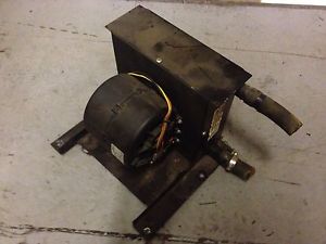

I used a London Taxi heater; the one they fit under the driver seat to heat the rear passenger compartment. It's compact (sits nicely on top of the tunnel) and has 3 speed motor. Just need to fabricate a panel to connect your air ducts to.
Picture stolen from ebay:
