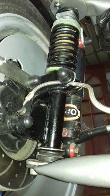

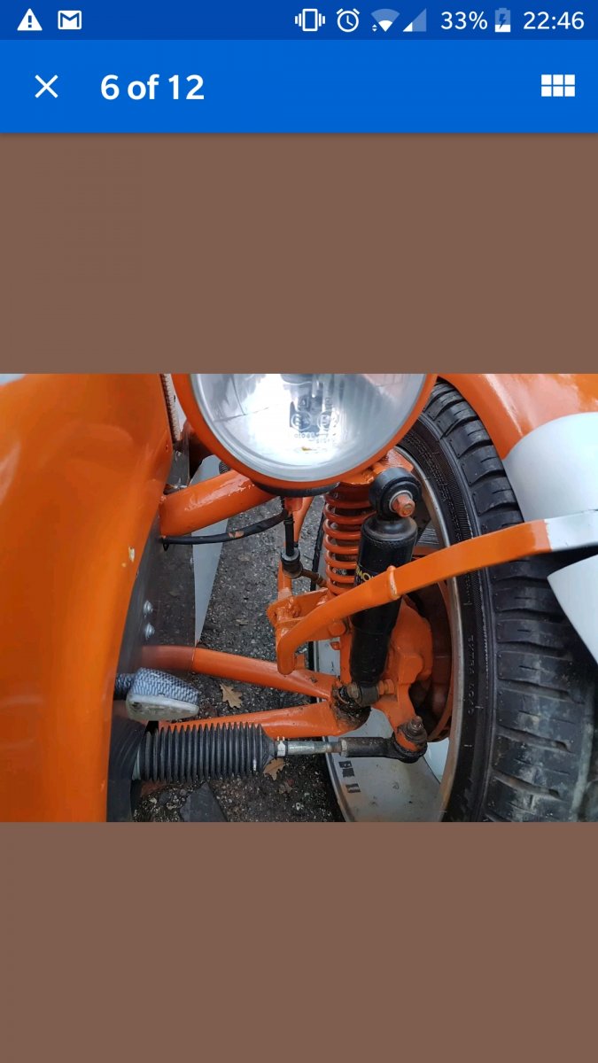

I need to get replacement king pins for my sliding pillar 2b. I have only just purchased the car recently. There is a lot of free play currently so I believe it is this. Attached is a photograph of the setup. I believe it's the sliding pillar system.
Hi Conner you are right it is the sliding pillar set up.
I am sorry to say but your picture is not showing me how the shaft is being secured at the top and bottom to the frame of the chassis.
My car is also a sliding pillar but I have made many mods to the setup to secure the shaft.
The shaft (king pin) as your description was from the front Sierra strut of the car.
Would it be possible to clean off the dirt from around the bottom mounting also a better pictures of both top and bottom mountings so that I can ex-plane more clearly for you,
The shaft needs to be very securely mounted top and bottom then any play would only be from the bushes that slide up and down the shaft of the pillar.
These can be re-bushed by an engineering company if you do not have the machining use yourself.

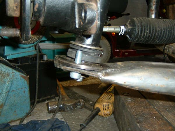

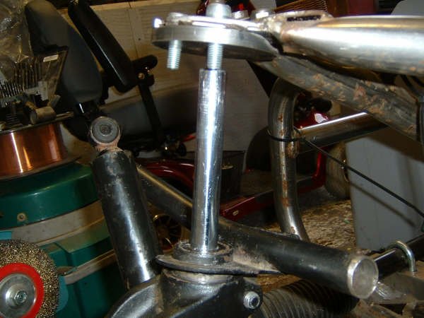

I have pictures of my setup but will have to down size them to post on here.
I have attached 2 pictures for you to look at.

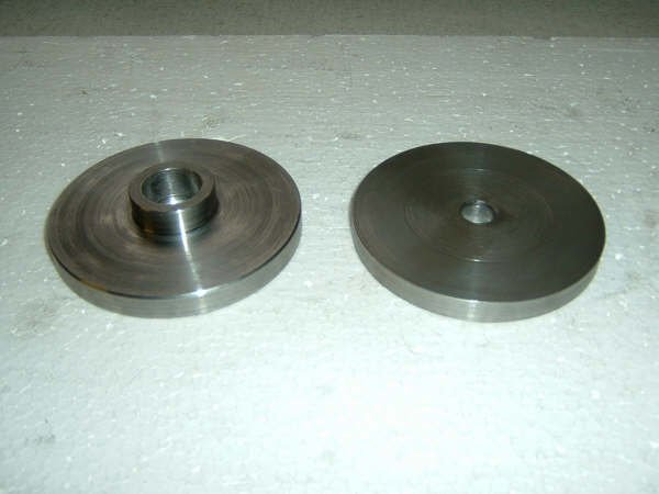

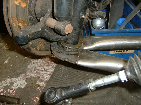

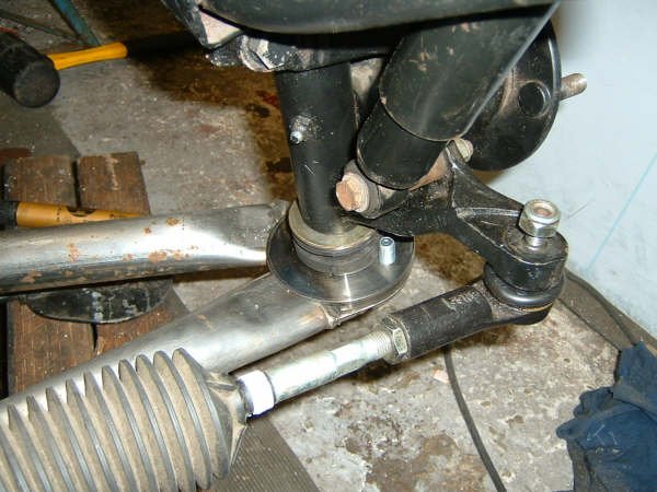

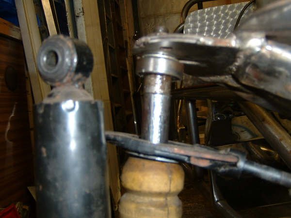

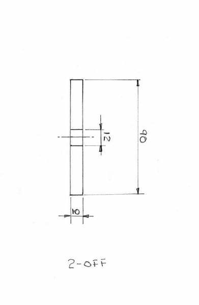

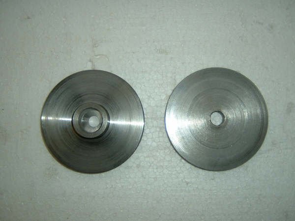

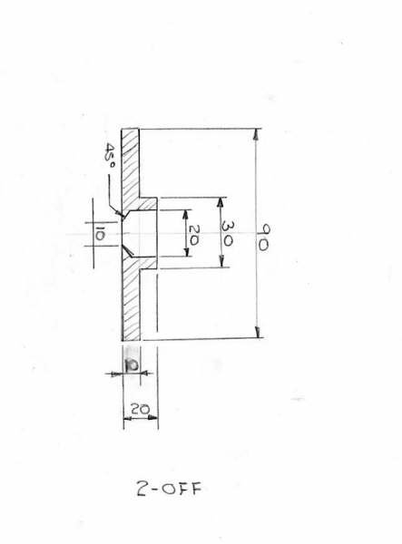

Hi Connor I have found a few more pictures for you to look at as mine was and the parts I had made to secure the shaft top and bottom.
Hope these pictures will help you of how I did mine.
Martin

This is actually very helpful I have ordered some that I think may fit but this seems to be more reassuring thanks
