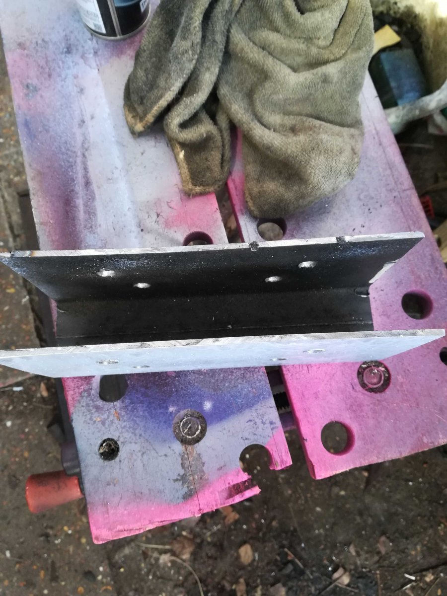

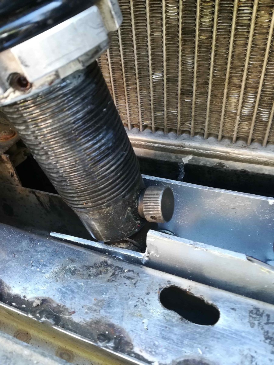

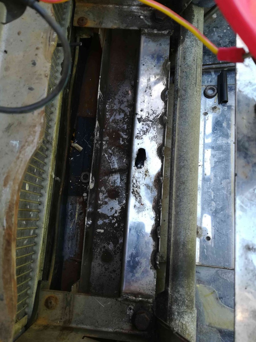

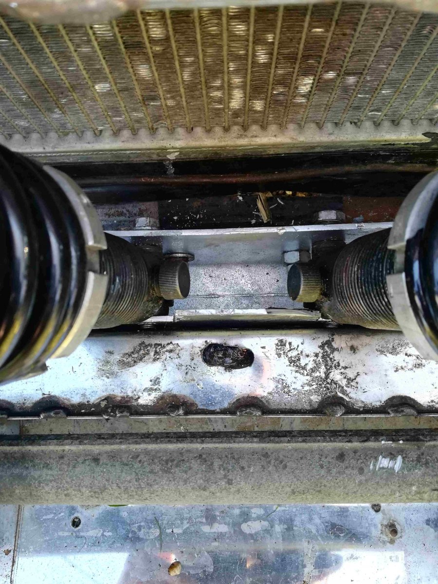

I had done all I could to increase my front clearance because the roads round here have some high crowns. I raised the engine a bit bur it wasn't enough. Here is my solution. There may be some worried intakes of breath from some but it has worked a treat. Nearly 2 inches more giving me nearly 5 inches. I fashioned a u shaped bracket that drops into the existing channel. Drilled holes to attach it to the existing lower coilover holes. Drilled higher holes to take the new coilover bolts.
