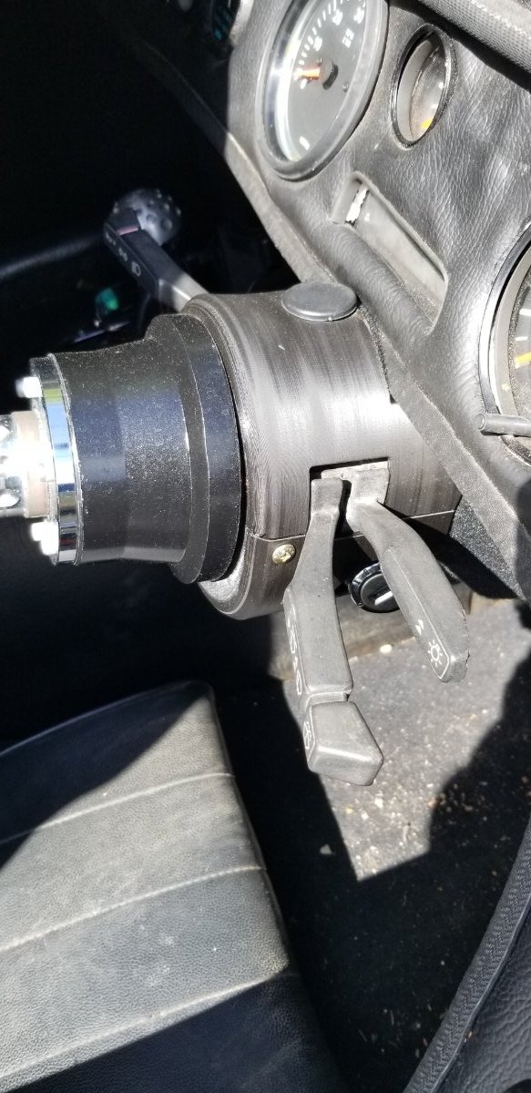

Raise steering wheel height / angle of steering column
dandan62 replied to Craig Poultney's topic in Mechanics
Hi. I had the same issues with mine although I'm a lot shorter than you. The seat type obviously makes a difference. I raised that horizon bar by drilling new holes about an inch with no issues, which helped. There is also a bit of vertical adjustment with the 2 bolts either side of the column I seem to remember. Best thing I did was fit a flat bottomed steering wheel which is removable. -

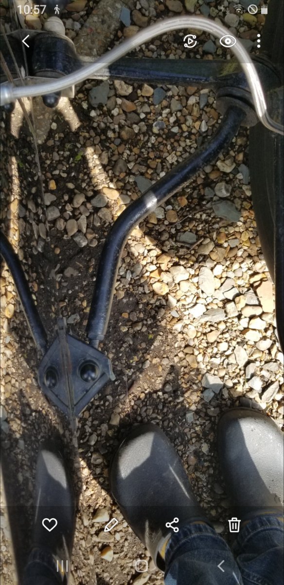

I saw your fb posts and pics of your front suspension. It's obviously not the usual lower suspension Sierra setup so can you confirm that the rearward arm is an anti roll bar( it goes all the way from one side to the other)? It looks thinner than the Sierra anti roll bar. I presume the usual tie bar mod would still work though. A rare model with the outboard coilovers.
