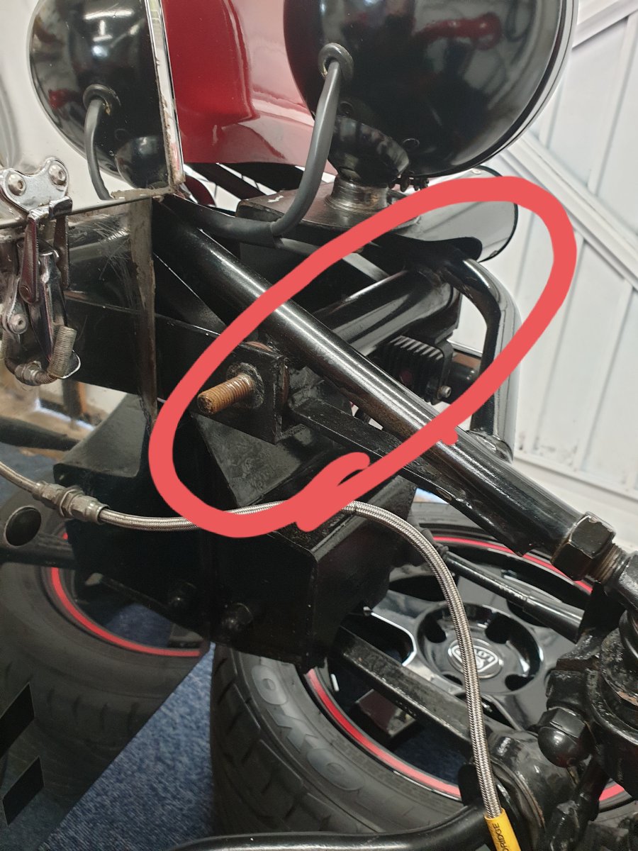

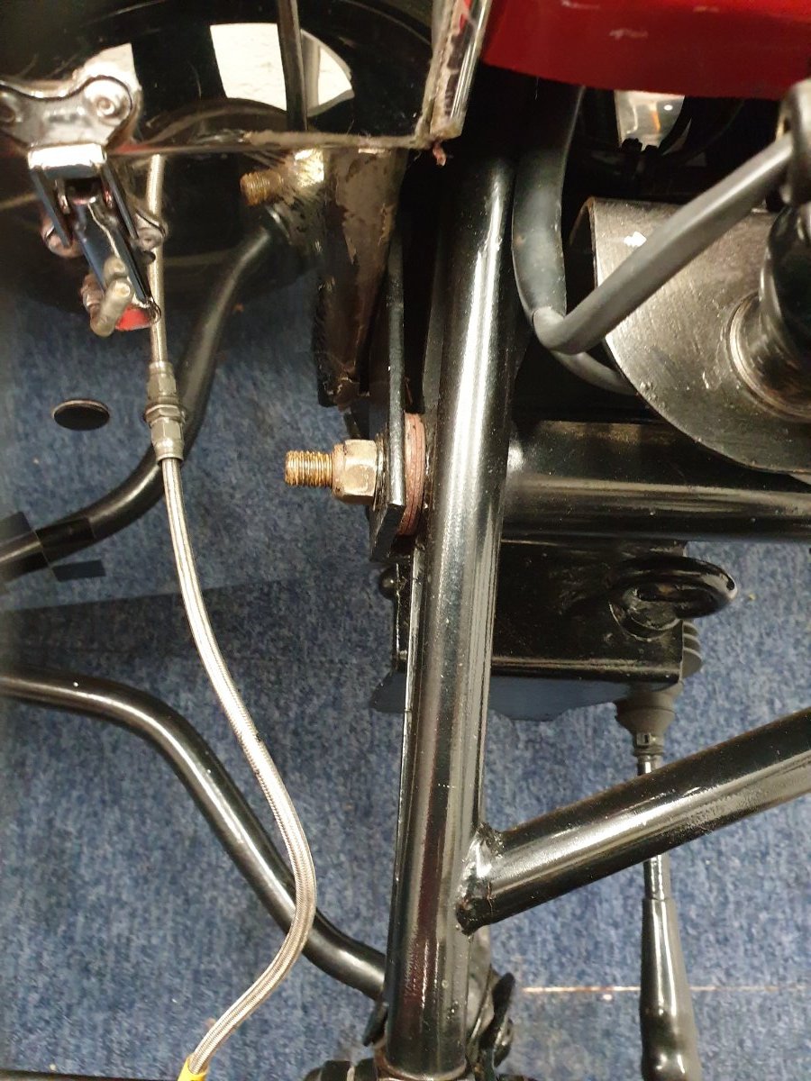

  4. Thank you guys, it is great to know what I have to do and I best way to tackle it, the pictures are great and it just goes to show how important this club is, the wealth of knowledge and everyone's willing to give advice is tremendous and I am so grateful. I will keep you up to date with my progress and thank you again
  5. Thank you guys, so once I have removed the nuts the threaded bar should knock out, then once removed the tube with the bushes should lift out so I can get to the bushes if I understand correctly
  6. Hi guys, need some advice before tackling my next job. On the drivers side I have about 1/4" play on this bush at the back that I have circled in pink, now I think there is a Bush the other side of this threaded bar/ bolt, it looks like it doesn't travel all the way through so another bush on the front, has anybody tackled this job and what is on the other side that I cannot see, my last question is how do I get in to repair, amy advise would be very appreciated. Thanks Andy

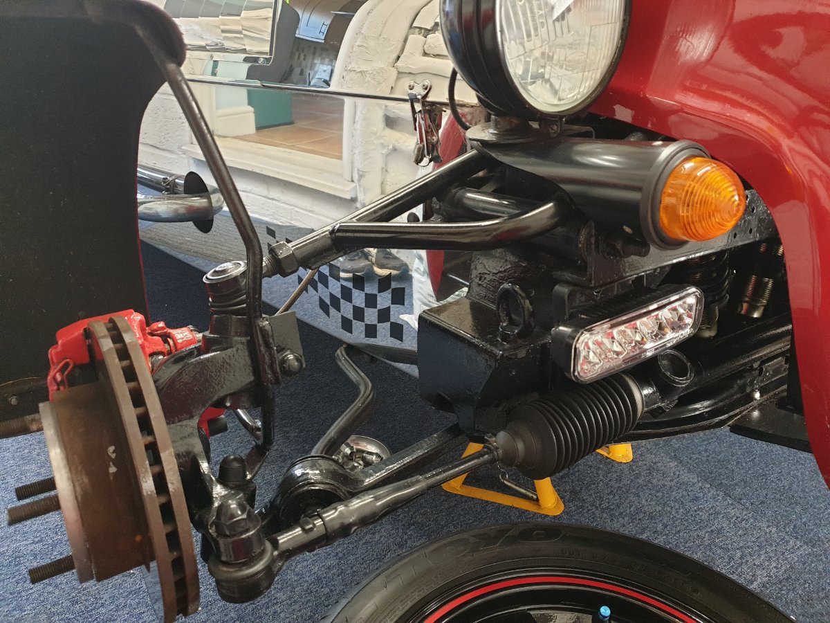

  13. Hi, my winter project is to change the rear and front suspension, i have the rear suspension covered but the front I need a bit of advice on. I have a sierra base S7 with in board spax adjustable coil overs that came in the kit I would think, I want to keep with the in board adjustable coil overs but i think the the springs are a little to hard but do not know what spring rate is fitted but more importantly what springs and shocks should I get and where to get them, i love the ride but just think a softer spring would be better without going to soft. Any advice would be grateful especially from anybody who has changed there shocks with this set up. Cheers Andy
