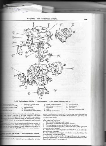

This one illustrated also has a stepper motor connected to the ESCii module for the idle speed.
Hello
I believe the DTML is a straight replacement of the DFTH and gets rid of the problematic stepper motor.  I guess it should have the same layout as the one in the Haynes manual in the previous post.
