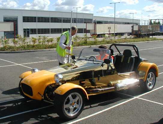

I had my SVA today on my Super Spec, after the last time they refused to test it because of a little overheating problem :p
Result: Fail :boohoo: , as expected, but not by what i was expecting to fail on!
Ok the list:
1) Demisters don’t blow hot air, these are the crappy ones supplied by RH, yes they should blow warm air but i disconnected the element to get more air flow (stupid boy)
2) Wipers do not clear enough, just a case of the wiper blades being not at 90deg to screen, easy to sort.
3) Innermost seat belt anchor point not captive nut, you must be able to undo nut on your own, outer are ok because you can reach both the nut and the bolt, solution weld the nut to a plate on bottom of floor.
4) Lower edge of dashboard not radiuses to 19mm, it was radiused to about 15mm but wasn’t "non rigid material"
5) Wiring in passenger scuttle not secure enough,
6) Rear handbrake cable mounting brkt too flexible,
7) Lambda sensor not working correctly,
8)Front brake pipes need to be more secure where they pass through the body of the car,
All in all a good result i feel :) , it was a great day for a blast in the hood, it took 1 1/2 hours to get to the SVA ctr and 3 to get home because i went the "long way" round some twisty roads and it was fantastic B) , it has been worth the time building in the cold and dark just for today.
Big thanks to Jim and Mitch who supported me today real ambassadors to the RHOCaR club.
The examiner was a really nice bloke who was very helpful and a good laugh.
Still grinning now :D :D , got a retest date of 24th September (my birthday what a great present) so better get cracking.
