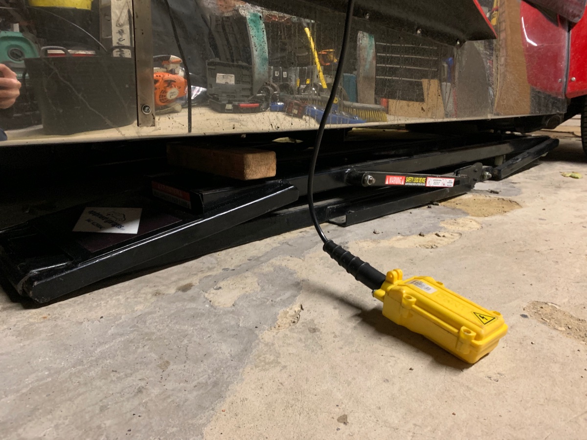

I have just bought an Exmo and about to Jack it up to change fluids etc and have a pair of lifts I usually use but not looking promising for jacking points…..anyone have any advice?
I really like using these lifts as they get the car full off the ground safely and level to help with draining fluids, etc. I have attached photo of the situation.
At the back the rear subframe is good as it has a large spreader plate bolted on top of the floor.
At the front I have always used the inboard mounting points of the track control arms, I am unsure if your jack system will work for points that far apart.
I once saw a MOT tester jack my car from the rear anti roll bar mounts and cringed but no harm was done.
