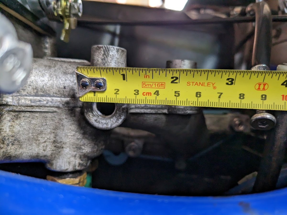

CBS do a wide range of hose fittings    https://www.carbuilder.com/uk/         but you'll need to know what size hose and what thread is in the inlet manifold.
If it's a standard manifold I'm sure somebody on here can tell you what thread it is.
It is a standard manifold, yes, and looks about 12mm or 1/2" and servo hose is probably 6mm ID but need to check. Is the thread BSP or NPT?
Looking at a Ford parts catalogue it says  1/4" NPT which would be about right from your measurements  ...........  but I can't sure.
