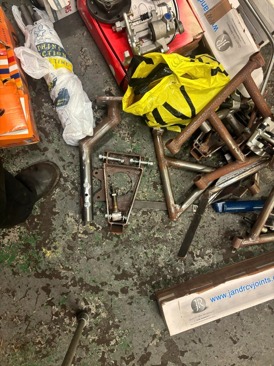

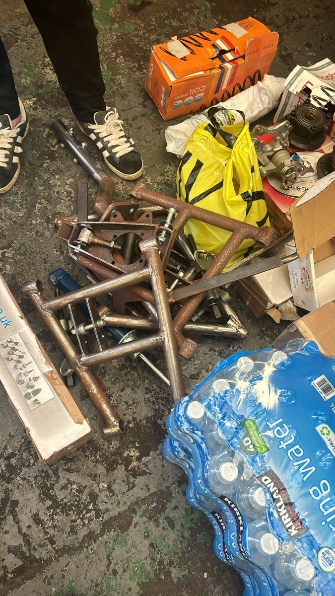

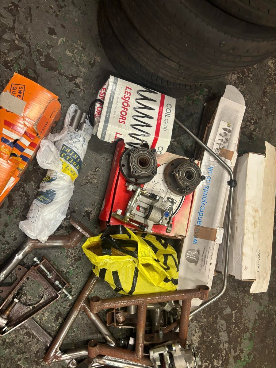

I have come across these suspension parts, they look well made. Does anybody recognise them from a specific model?
Here's me wondering if to scrap the sierra rear end and try to make this work 🤔🤔
Your biggext problem is that there are no suitable locations on a 2B chassis to mount the wishbone pivot points. You will need to make up a subframe to install in the chassis first. I looked at this years ago and decided it wasnt worth it. With decent coilovers and vorrect height setting, the Sierra setup can work very well.
