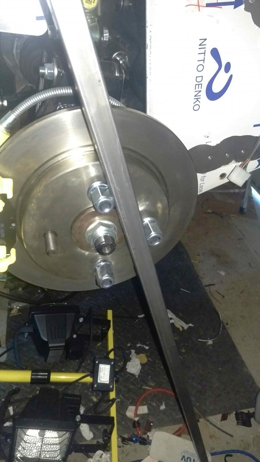

  1. Went down the steel bar route, bnq job and worked an absolute treat. Thanks again guys.
  2. Yup, hub nut. Thought about using hand brake and didn't think it would be strong enough, it wasn't (my curiosity got to me!). I think I'll wait till the engine is in, bit of a pain as I'll have to take the wheels off again but no biggie.

  4. Evening all. So, my alloys are on order and I'm prepping car to get it on the ground - exiting times. Now, another question - how the hell do I torque the hub nuts without the hub spinning? I've got a torque wrench which goes to the required nm but I am stumped for ideas, I have both rear and front to do. How did other people do it? Thanks! Danny

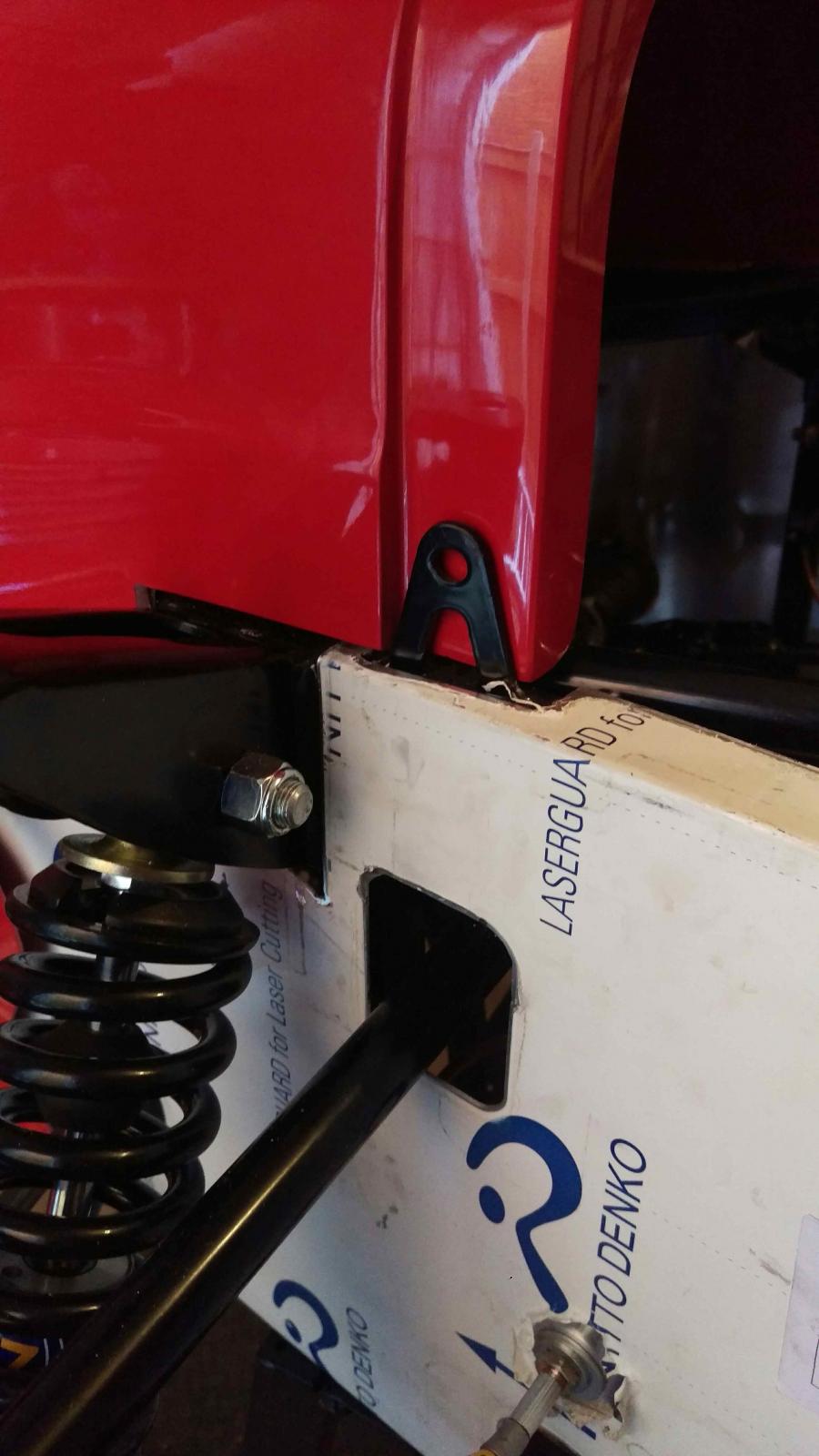

  8. thanks. I got it to fit in the end, on the outside. I had to cut about 1cm off each side at the bottom, it looks fine and is hidden anyway.
  9. Thanks, I'm nervous about cracking it but after trial fitting the bonnet it will fit much better if it's on the outside of that tab. Hmm, coffee time.
  10. Afternoon, another question from me. I see on various blogs and pictures that the GRP goes on the outside of the mounts on the top of the chassis. There's no way mine will fit on the outside without seriously stressing the GRP. I am wondering if I have a different nose? My kit was purchased in 2014, it's GT and the nose fits perfectly as pictured. I wanted to be sure before I drilled anything.

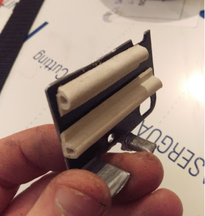

  18. Yup I think that's the issue, I've used far too much glue. I did read through your blog (very informative BTW) but it looks much easier in pictures and words than real life, as usual . I'll take another look after work.

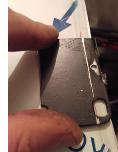

  20. Quick picture showing what I mean, it's hard to see but towards the bottom there is maybe a mm gap between the tube and the edge of the aluminium - I think it looks messy and will be obvious when it's on the car.

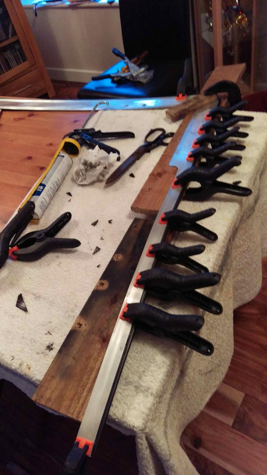

  21. I started the rear panel this weekend, really pleased with progress and result so far - except for the trim. The tadpole trim that goes round the top strip, what do people use to fix it? I've used the black glue that attaches the panels and I'm not satisfied with the result. The trim doesn't sit right, hard to explain but I expected it to lay underneath the aluminum but I'm having to use clamps to hold it in whilst glue sets. It looks kind of messy, from a distance it's fine but close up not as neat as I thought it would be. Am I being too much of a perfectionist? Would a different adhesive help? Interested to know what you guys used to fix. Thanks!
