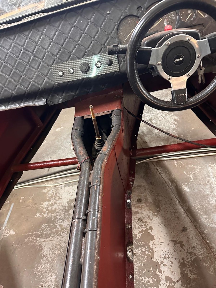

  5. Finished off interior ( bar a redo of the dash once I’ve got it on road) fashioned up some pipe works to create arm rests and fitted seats in

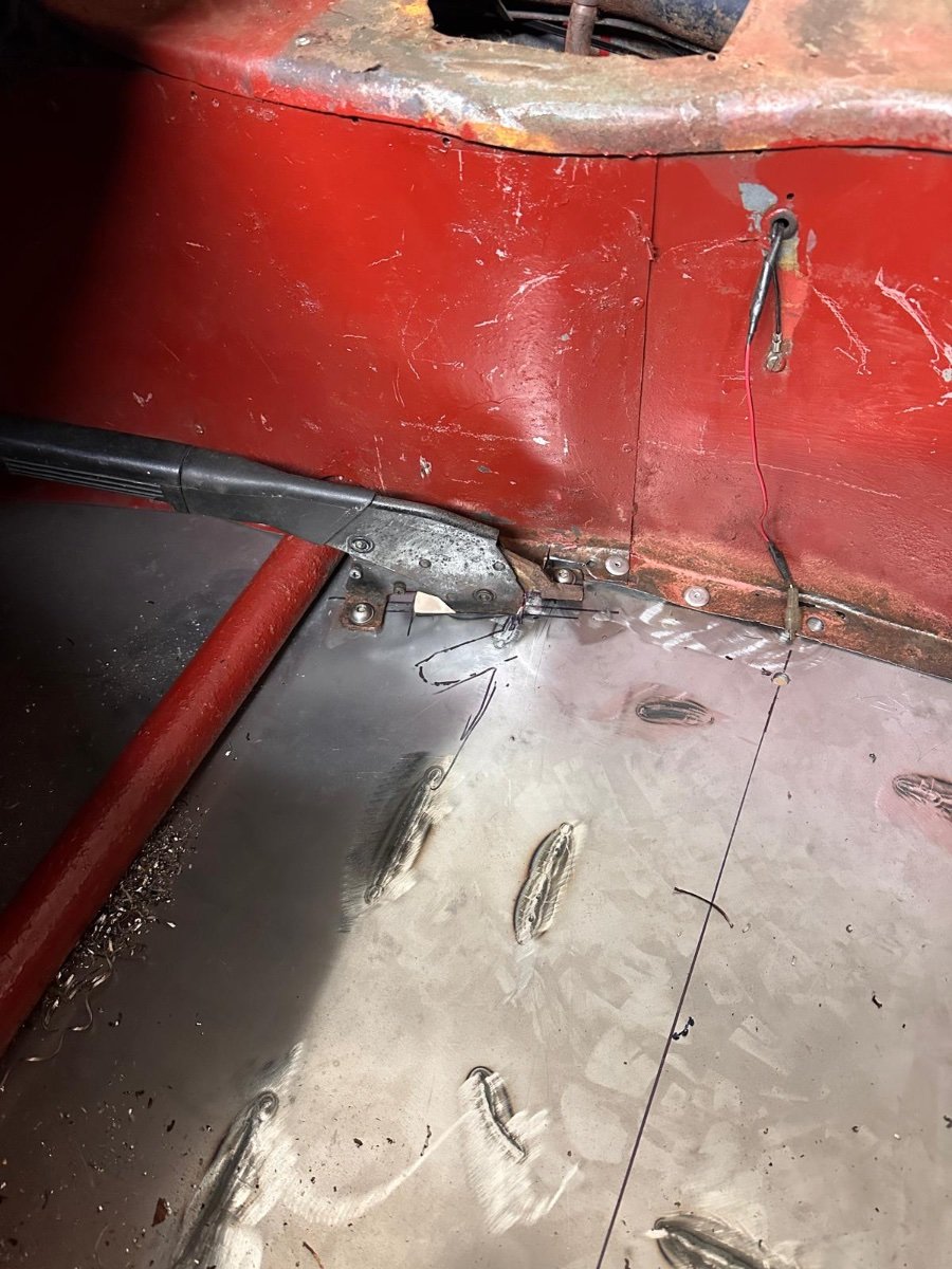

  17. Due to the larger seats I’ve moved the handbrake further forward and added an extension plate in

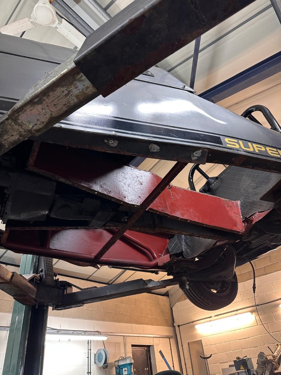

  18. Sealed it all and now seats and harnesses going in back tomorrow ready to go for mot shortly after finding a new fuel sender

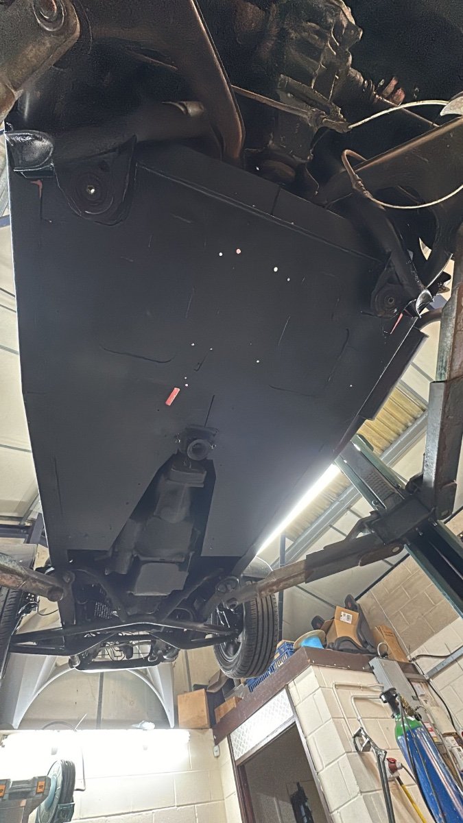

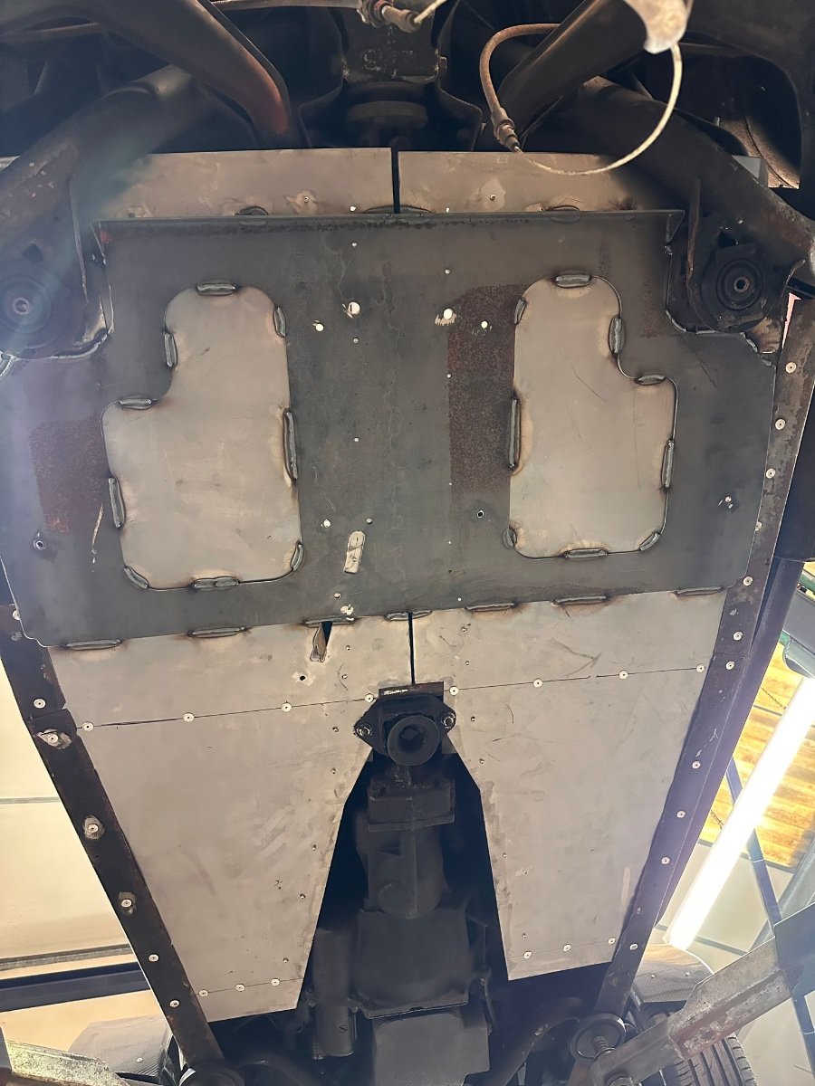

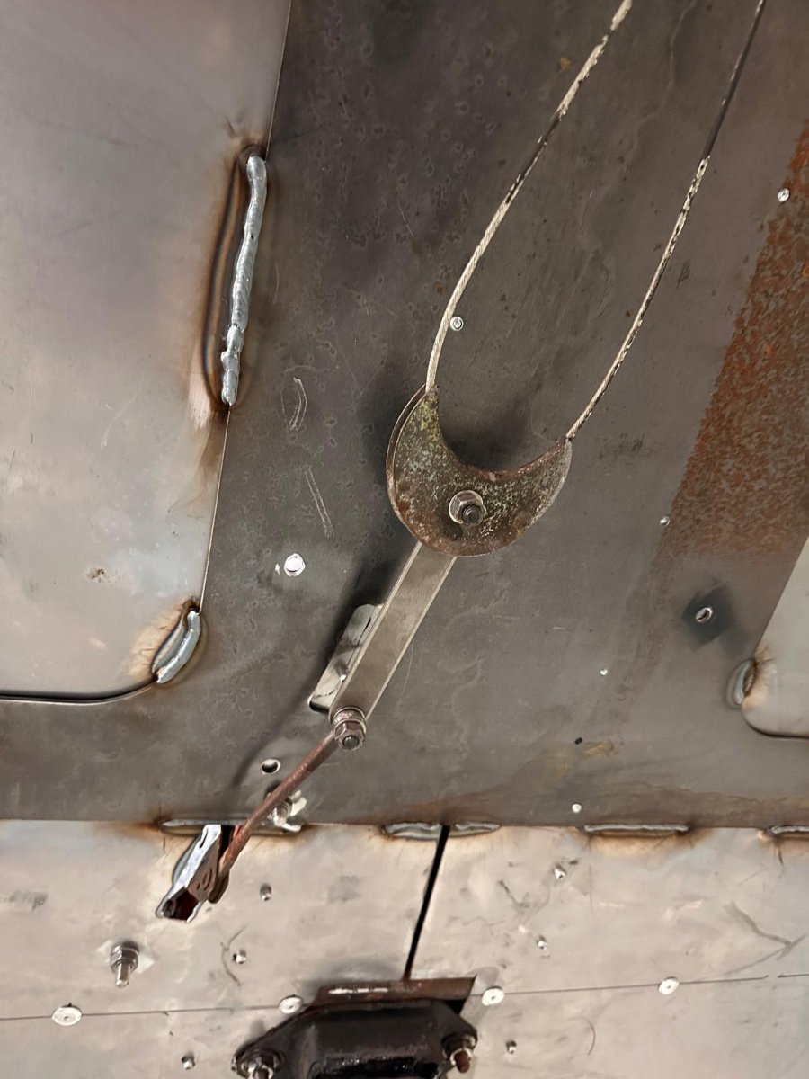

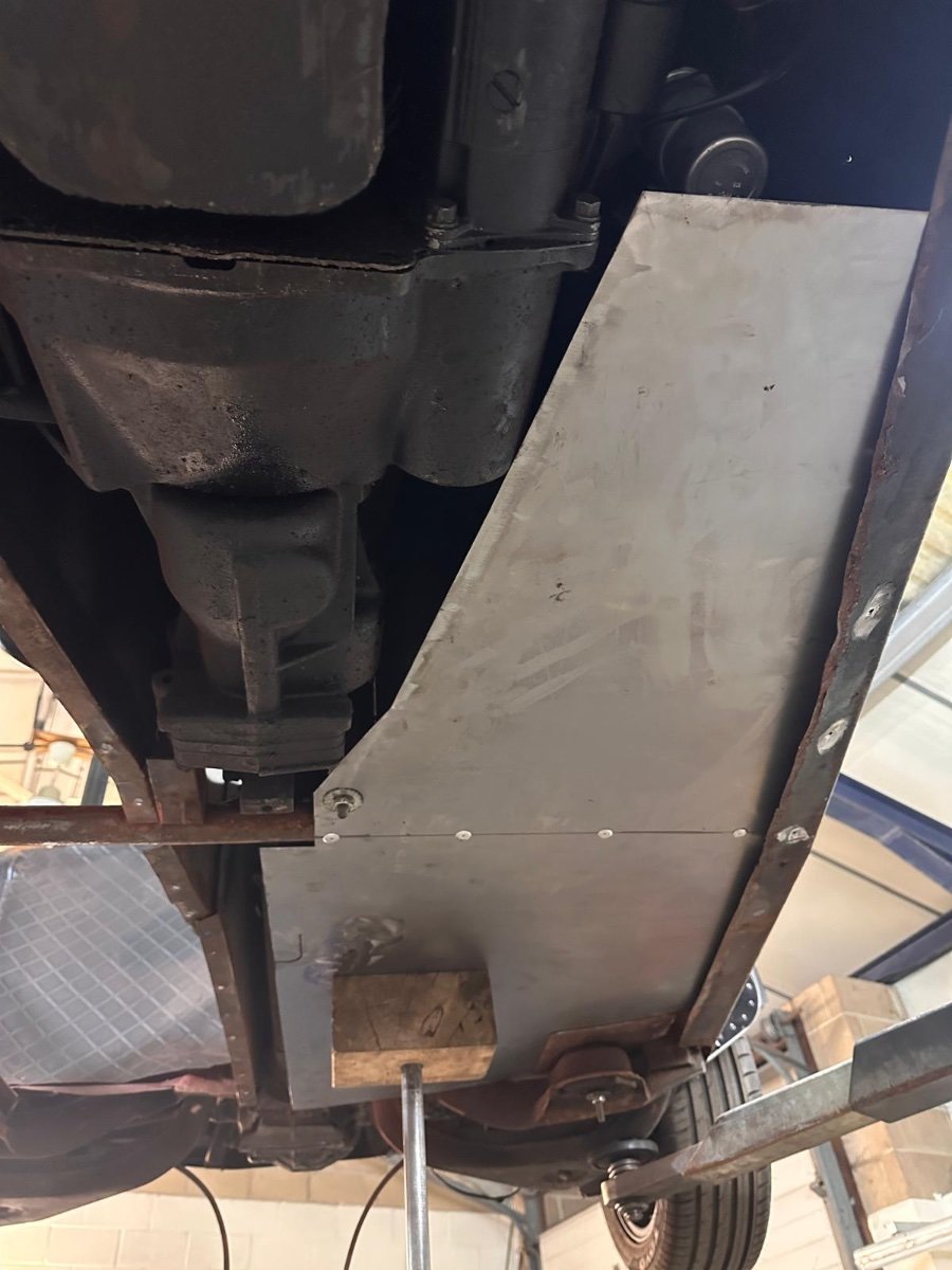

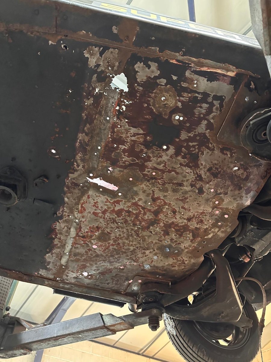

  19. Purchased a complete floor from gbs but had to cut it up to fit and so that I didn’t have to take the sides off, we cut it and slid under sides and re fixed it all up nice, I also added the strengthening plate whilst there so that it’s nice a sturdy and hopefully will really improve the chassis

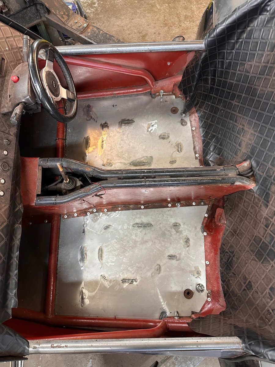

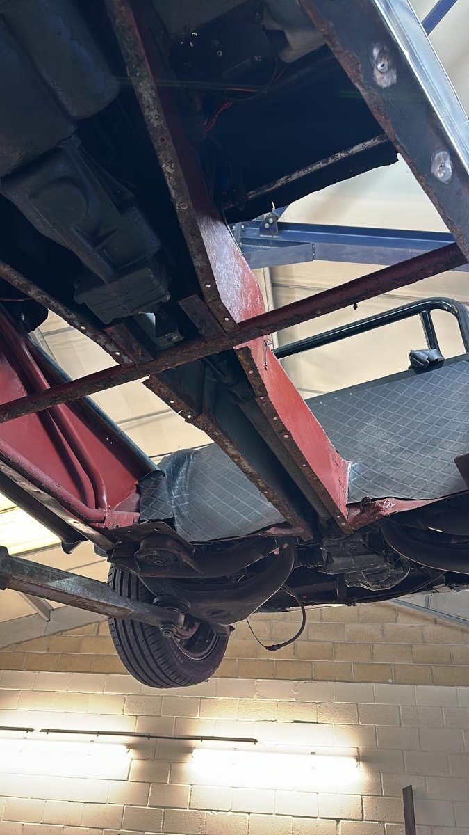

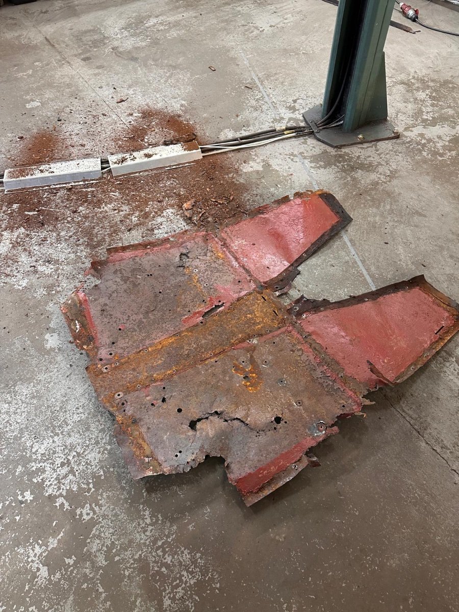

  20. So I had to go down the route of taking the whole floor out

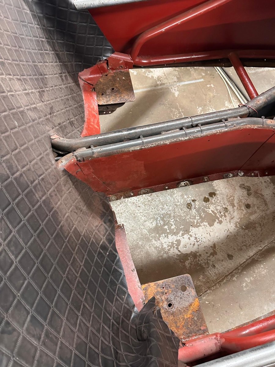

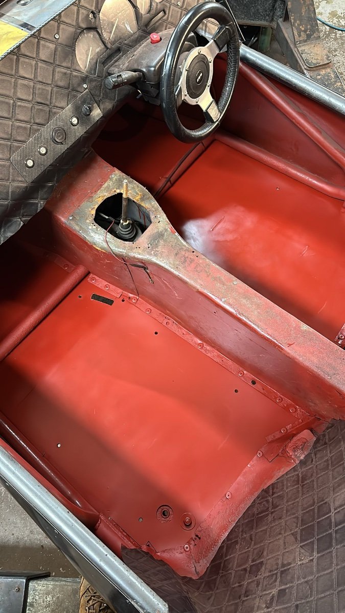

  21. So a complete mare with the seat mounting in the car, a complete “opening a can of worms” situation, albeit needed…. So the seats I wanted to have both on runners, which needed some new holes. However upon cleaning back what started as sheet metal with a few holes in the floor, turned quickly into holes with a few bits of metal in it.
