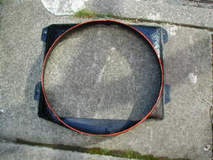

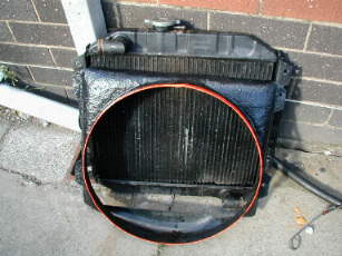

If you look, you'll see that the viscous fan is too low in respect of the radiator, there about 30% actually below the bottom of the rad. It's also some distance away from the radiator to be effective.
the way to sort this is by making a cowl around the radiaotr & fan, I made a wooden block then made a fibreglass cowl from it (I still have the block) that makes to fan draw it's air through the radiator only.
This was fine for "normal" driving, but should you want to get a bit enthueastic, the rad just wasn't up to it. There were no Colman rads available in those days, so I had a mark 2 Escort rad fitted with a double core from a V6, everything was fine then. (I still use that rad with the Vauxhall engine fitted)
1 other thing, the viscous fan's can go "weak" we found out with the Jeep when that overheated, you could be running the engine at reasonable revs, and stop the fan ever-so-easily (not with your hand!!) a swap of fans cured that.
My opinion is to get a Colman rad, fit a GOOD electric fan close up to the rad, or cowl it in (not a RHSC one) with a switch in the top hose wired as per our site, and fit some vents into the bonnet (again check our website for these)
The photo's are of the cowl I made and fitted.
