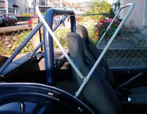

  1. Adding a couple of pics to illustrate. Don't forget the rear camber shims and for a great leap forward a viscous diff. Not caterham standard but better than all the other Hoods before the zero.

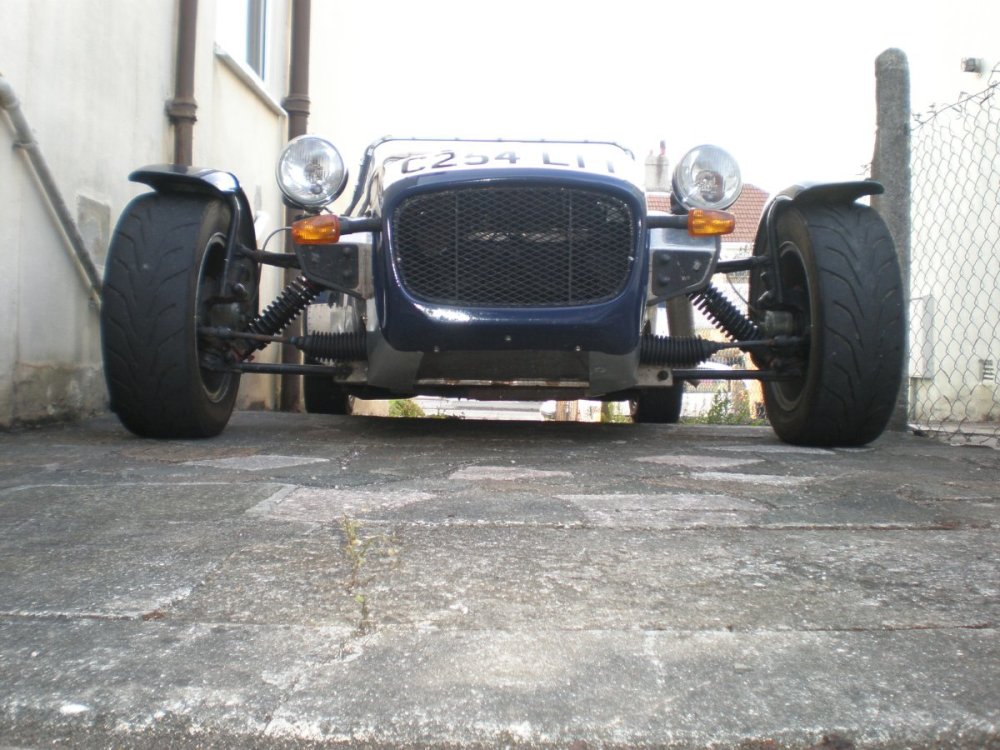

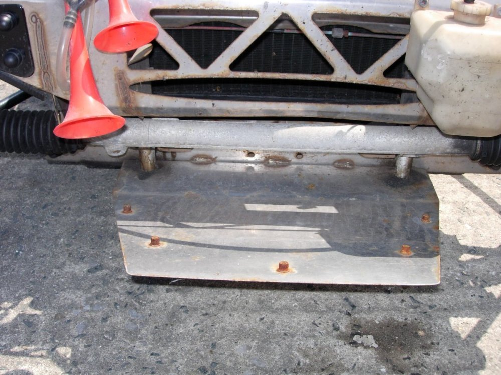

  2. Peter, You should remember that the 'New 111' had double unequal length wishbone front suspension, outboard shocks and springs, and no roll bar/tie bars. I ran 100 lb springs at the front. Rear coilovers mounted from the lower end of the roll hoop to the centre of the semi-trailing arm spring pan (not to the old sierra lower shock mount). At 120lb. The steering rack needs to be shimmed upward (on mine over an inch) to get rid of bump steer. The mushrooms to which the outboard end of the upper wishbones attach need to be raised about an inch also, not bolted up at their lowest position. Watch rotation of the mushrooms. In the wrong orientation the ball joint can lock up.

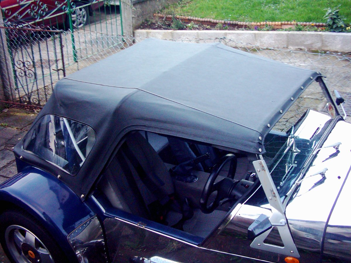

  9. Pics below.A lot of trial and error with the mounting point to tub position, length of each vertical and horizontal element and mounting point of rear shorter bar. You can get close straight off easily enough and then just cut and weld the elements to fine tune the fit. Screen position is critical. Not to far forward or back. Fit screen poppers. Then fit only the poppers across the back panel, not the sides. Then fit the frame and adjust for best look. Note tensioning between roll hoop and front bar, not between the two bars.

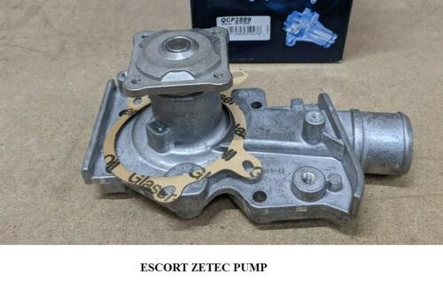

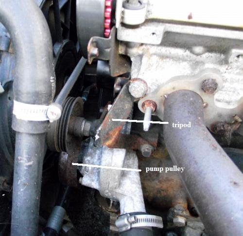

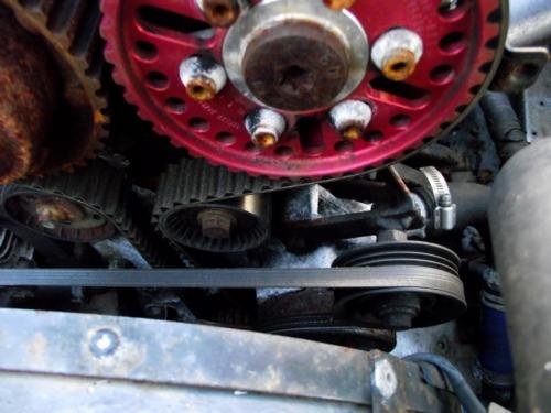

  15. Sadly it's me thats too old and the car too fast. I don't remember corners used to come at me so quickly. Painful but the time has come to sell. The last and best performing of the Monocoques, Robin Hood New 111. Built by me in 98/99 not quite in time to avoid SVA but it was a first time Pass on 26 April 2000. Build principle was always function over form. Everything had to work best. There was a lot of Data on what could/should be modified or strengthened on monocoques and I did the lot. Front double unequal wishbone suspension. AVO shocks. 130lb springs. Rear sierra axle correctly rubber mounted, viscous LSD, AVO shocks. 13 Minilite clones, Toyo R888 Proxies. Steering rack raised/shimmed to eliminate bump steer. Shaft mounted on swivel ball bearing through bulkhead. Pedal box with twin master cylinders and adjustable balance bar. Mintex. Engines have been pinto, silvertop, blacktop, silvertop and finally ST170. Raceline ally sump. Jenvey TwinThrottlebodies. Omex 600 ECU. Piggybacking Mtec VVT controller. 4:2:1 tuned length exhaust with excellent collectors. Was 196 BHP on the rollers for a magazine shootout 8 years ago when it had shonky injectors. Injectors replaced but not been on RR since due to health /caring issues. OK body. Rough glass. Lives outside. Best fitting hood in the club. Doesn't leak. Good mini heater. VDO dash. ECU software on an old laptop. Some of the older members will remember the car from shows and Barkstone where it was always one to beat. For the last 8 years I have been caring for a family member who has now passed on and the Hood has sat outside unused. MoT mileage each year but it does look in need of a little TLC. Spares Nosecone. Side screens. ST Engine. 'Tons of stuff. Take what you want.' So there we have it.Very quick, well handling car to scare yourself in. Does have one years MoT. £4000.00 Drive it home, enjoy it all summer and smarten it up next winter.

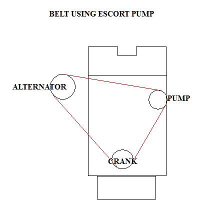

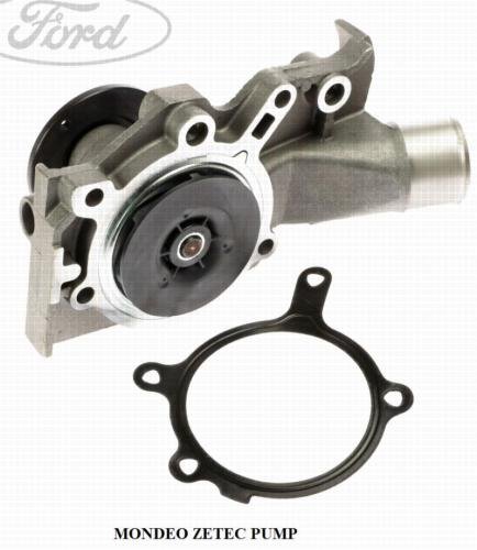

  18. Escort/fiesta 1.6 pump. Not Mondeo 1.6 pump. My later solution (I first had a silvertop, then a blacktop then another silvertop and lastly a ST170) was to make up a three leg pedestal holding a V groove pulley and run the mondeo pump off the back of the belt. There are handy bolts or holes to mount it.
