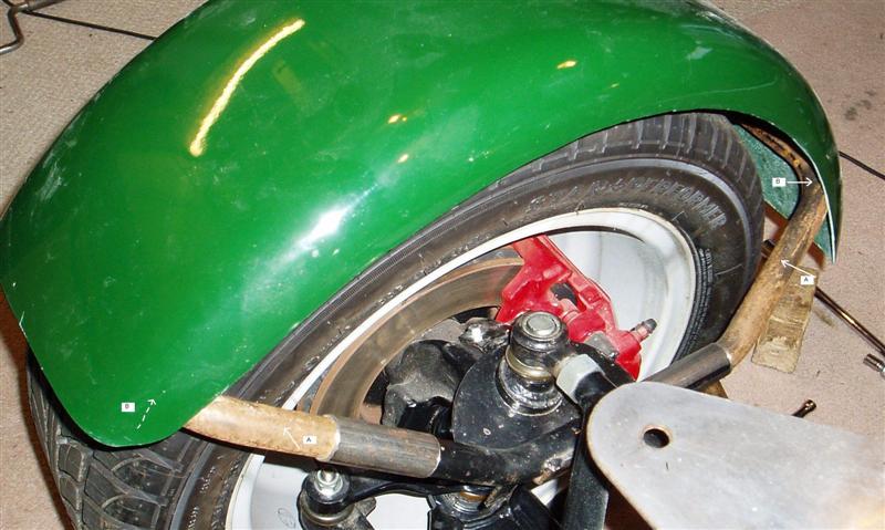

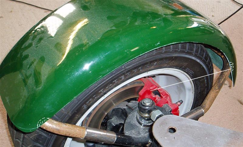

Hi All,
Just fitting these now - Things are going pretty well.
To get them to fit correctly though, it looks like I'll need to take a couple of bites out of each one (see photo).
Before I do though, is this fairly standard practice? Or am I on the wrong track here?
I managed to fit mine without taking anything out, though I have seen a few examples where they've taken chunks out. Personally i'd try to avoid cutting into them.... it is possible to fit them without.

OK - Thanks Jon,
I agree. I'd rather not bite into them. I 'll see if I can persuade :) the brackets to move outwards a bit.

Some people have abandond the supplied tube in favour of flat bar.
It allows a closer fit to the tyre aswell.
Might be worth a moments thought before you make your final decision.

Thanks for the tips. The trouble I'd have with flat bar is that I don't have any welding facilities (or skills :) ).
I've tried bending this stuff in the vice, but it's too strong. There's a hire shop near me, so I'm considering hiring a pipe bender - I'll go and have a chat with them and see what the options are.
As per the photo, I'm planning on bending at Points 'A' and straightening at Points 'B'.

My original guards had cut-outs to make them fit, and didn't look very good. I think this may in part be caused by trying to make 8" nominal width guards work with 205 (8") tyres. When I get to them during the rebuild I hope to come up with something better. There seems to be some 9" wide guards around on Ebay and other places which should help. Not sure what is supplied in later 2B kits, but mine were the guards supplied as standard in 2002.
At the end of the day I think there is going to be a lot of heating and rebending involved. The bar which is welded to the dummy McPhearson strut (originals were on a separate plate that the strut passes through) looks like it needs a good tweeking and is going to be especially tough :(
I've been having another ponder about this (Yes I know I should get out more :D ).
As everything's now been cut, the pieces are quite short - I could be tricky working them in a pipe bender.
Next plan therefore is to get hold of some 15mm box section and use it as a sort of spacer. This should bring the elbow's of the bends away from under the guard by the corresponding amount (15mm). See drawing.
I think this may do the trick.

Trouble with doing that is that the guards will be further from the tyre. Mine were too far away and spolit the appearance.

i know you haven't got a welder, but heres how i did the cycle wings
i used 3mm flat bar from B&Q welded to the brackets and plugged the ends to make them sva friendly.
once its welded on the bar is easy to bend to fit neatly round the tyre but strong enough to hold the wing firmly in place.

Grizzly -- have a look at Baz's front wing fitting ----- I did that using flat plate and fitted Dax wings getting them really close to the tyre making all the difference - I think it looks really neat

Will do! - I could've done that last night but didn't because I thought they'd be completely different to what I have - Doh!
