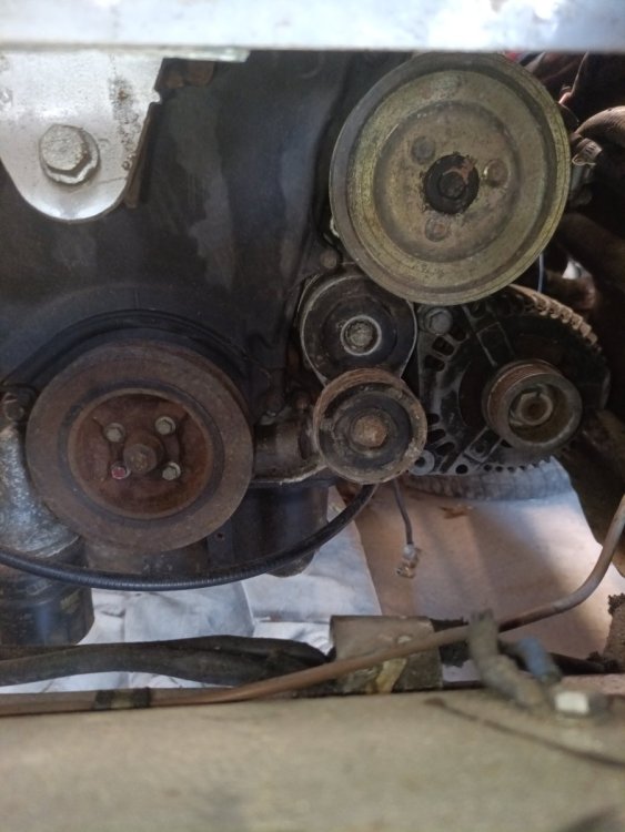

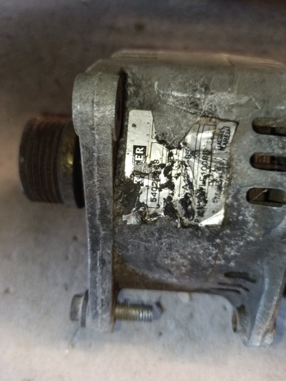

  2. I'm really not sure that the alternator, which came with the car, loosely hanging on one bolt is the correct one for my engine... The part number of it isn't easily read but starts 5402..... The more I look at the car the more I see that's been messed with.... Can anyone advise which is the correct alternator for the T16 engine with steering pump? Thanks, Jon
  3. Another pic

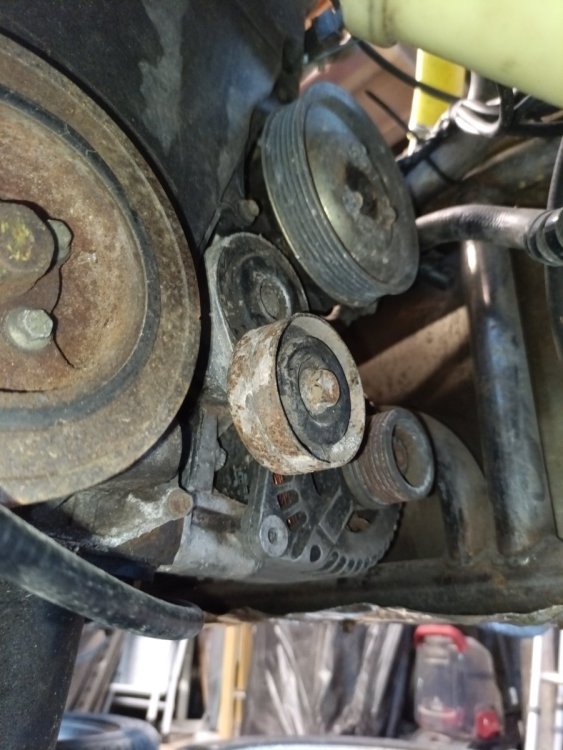

  4. My power steering pump is above the alternator.. . perhaps they're on the brackets in the wrong positions? I really can't see how the alternator could be mounted any further forward on the lower mounts where it is now and it doesn't seem to line up that great with them either
  5. Thank Andy, yes it’s definitely mounted incorrectly. Off to the garage shortly to try to get to the bottom of it.
  6. Hi All We're progressing on with our superspec repairs now that we have an engine that starts..😃. There's so many things on the car that have been messed with and not put back together right, even bolts missing from brake calipers, manifold bolts etc. Out next step is to get the plumbing sorted so we can run the engine to temperature. There's no belt on the water pump and alternator but I can't see how this is going to work as the alternator pulley is around 2" backwards from the line the belt should run on. Does anyone have any photos of that area on their cars they could post for me to get some insights into what's wrong with ours? I'll get a pic of ours later too. Cheers, Jon
