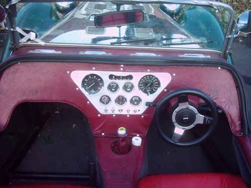

My dash was the Robin hood stainless panel covered with an unpicked red leather jacket from a charity shop. I cut out the aluminium by hand (using a hole saw for the holes for the instruments), switches and push button start from Maplin's. The gauges themselves are a combination. Mostly bought as non working (but pretty!) gauges from autojumbles, friends, etc, and the Sierra electronics fitted into them. Getting those to work and be calibrated was the only hard bit of the operation!

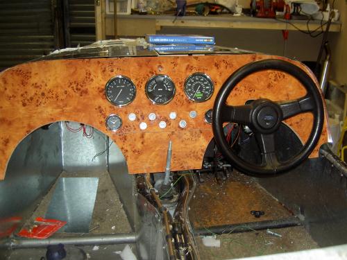

Dash about 50 notes from europa and instruments smiths tailor made (expensive). All shaped and holes cut using hole saw,
will have to be altered a bit to adjust sterring wheel angle
