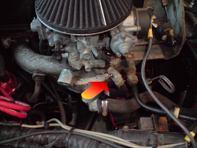

I had similar problem on mine, would not idle well or cut out whilst slowing down.
Friend of mine spotted this:
There had been a rubber cap there last time we looked and it was sucking air in making the engine run lean, blocked it off again and the car now idles fine and nolonger cuts out.
