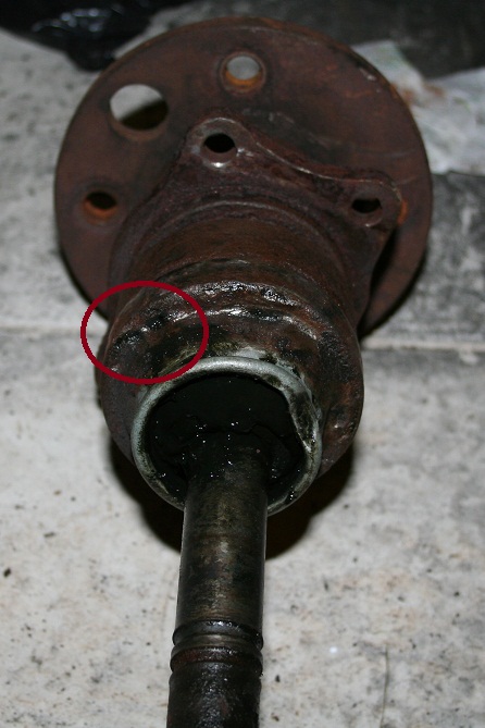

I'm starting to clean up the drive shafts GBS supplied me with and one of them has taken a right beating, the joint casing has split where it's been lumped with a hammer a few too many times.
Before I remove the casing I've been trying to track down the replacment parts, but I keep coming across either bolt together CV joints or Push together where the sleeve is a single piece. The ones I've got are a 2 piece sleeve ! ( The inner section slides over the main cover.)
I'm guessing this is just an early or late version of the single piece sleeve, but if anyone can confirm it would be a big help.

I've been hunting through every builders pages / blogs / photos etc etc and can't find a pair of drive shafts the same so I opened up one joint.
I was expecting it to be a 2 part casing, but it's a cap over a solid CV joint body, rather than a sleeve that covers the whole joint.
I'm a little concerned as there is no sign of a matching pair on any builders site that they might not do the job now & also have no idea where to start the hunt for new caps as it doesn't match any sierra CV joints I've seen
Anyone got any ideas ?

Thats good news at they are actually off a Sierra then !
How did you get the cap off to clear out the grease without destroying it and the rubber seal ? i had a pig of a job opening this one up and have to cut through the cap.

Sierras came with two types of cv joints. Your ones are tripode joints but they also came with lobro joints which have a cage and six big ball bearings in. Motor factors or ford will sell you new ones.
Nigel

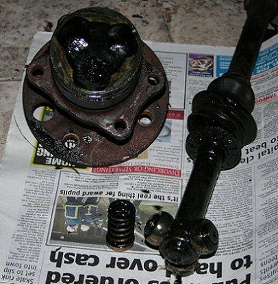

I'd tracked it down to being the Tripod variety, but all the info I could find on those drive shafts showed the main body of the joint like this...
(Borrowed img, thanks Joey ;) )
Not with the enclosed body like mine have (Hence all the questions)
