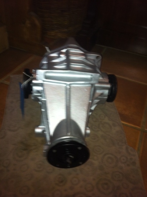

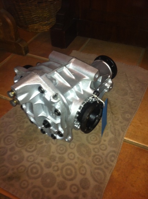

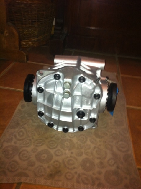

this is the 3.62 LSD from a XR4X4 i think it will do a very good job in my little zero when shes built lol
all the work was done buy road and race transmisions and i cannot rate them high enough superb serivice £360 got me brand new plannet gears all new bearings and seals shot blasted and painted :) what do u guys think

wish i could say i done it myself but all credit must go to road and race transmisions in sevenoaks great guys over there
i looked into buying a recon diff and gbs wanted 500 just for an open diff so i managed to get the back end of a sierra ( diff hubs breaks shafts etc) for 250 off ebay so its worked out cheaper already and ive got all the other bits i will need for the back end
