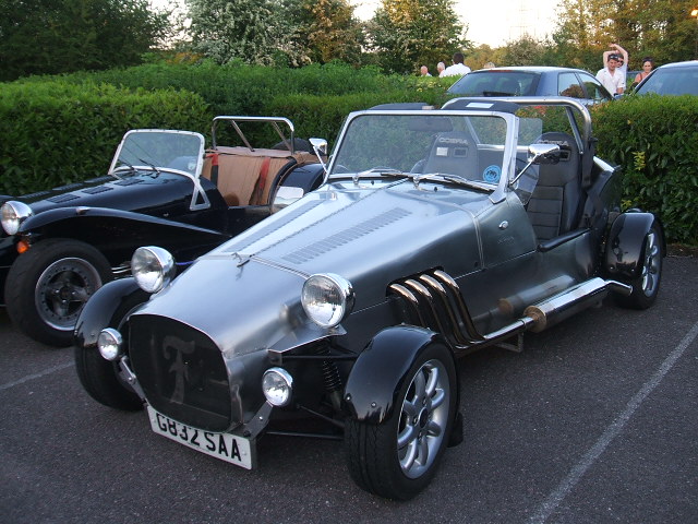

Hi,can't help with engine probs, but hopefully will see you sometime at the Cadnam RHOcar meet -- second Tuesday of the month @Sir John Barleycorn Cadnam,around 7-7.30 ish, regards Bob.post-3135-0-68232700-1338055001_thumb.jpg
