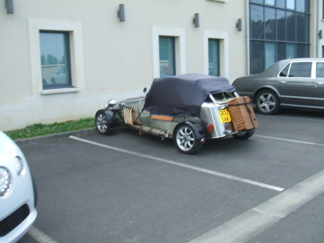

  1. Photo doesn't show petrol cap --- it's just between roll bar support& left a bit. almost directly above number plate light.
  2. Depends on tank I suppose --- Florins tank could go either way round --- hence my previous post & Florin's square number plate covers the hole in the upright of the panel.
  3. Fuel cap modified slightly -- to petrol pipe of ( 50mm ? ) diameter --to -- aluminium tube ( aerial mast piece ) to p/pipe.
  4. Inner back panel --- cut vertically down centre line & then slide/ fit each side without paying any attention to other side. When happy with result there should be enough over lap to join both sides. I bent riveted the top to the seat belt bar/tube. For the bottom I made & welded an inside/out triangle ( 120 degrees or there-abouts ) Rivet panel to this near up-right web & forward web will carry the back end of floor, which again I cut in two & bent to give the upright of the tunnel. ( allows full access to prop. HTH we are down in sunny Cornwall now so not much chance of up country visits.
