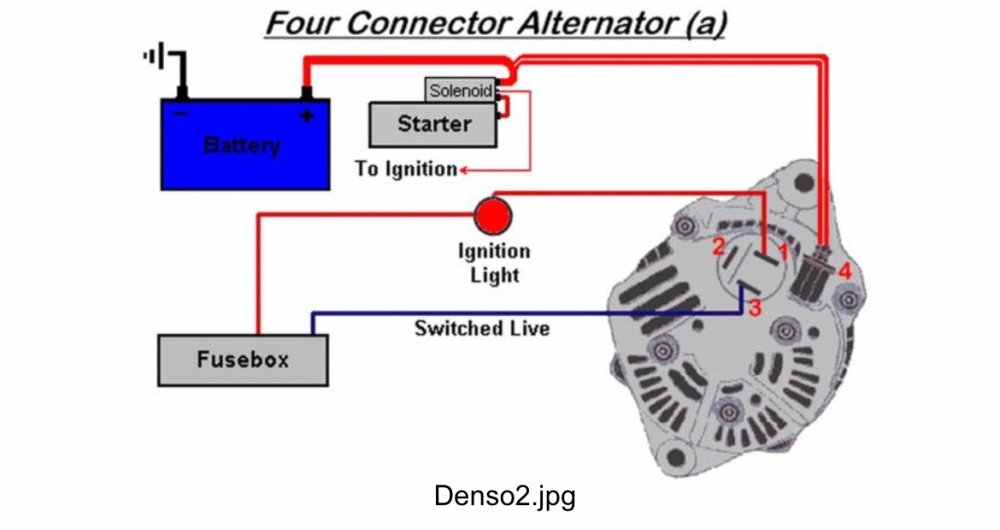

  10. I’ve done some more digging, based on what’s been said on here and I think I have a 4 wire alternator like the picture. I have a 6mm and a 2mm wire for the alternator (both going to battery) and both attached to post on alternator(4). I have a warning light wire too(1) - so 3 wires only. I don’t have a switched live going to the alternator at all, do you think this could be the issue?

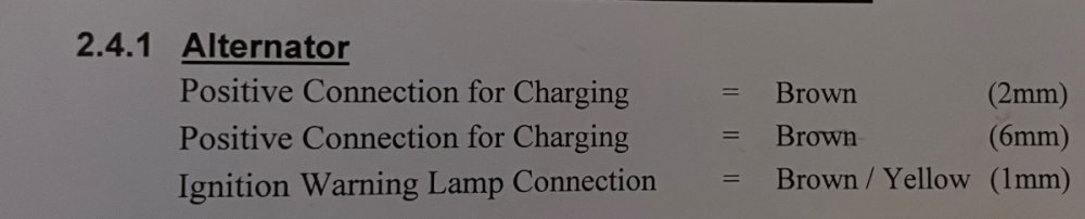

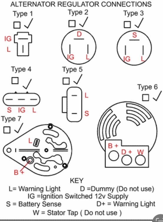

  12. Hi all, I need some help! Car now runs, however the alternator is not charging the battery - I have no idea if it worked before tear down, so fighting blind…especially as I’ve rewired the car too. The wiring loom has two positive wires to the alternator, a 6mm (main charge) and a 2mm called ‘positive connection for charging’. Currently I have them both to the +ve post on the alternator but it’s not charging. Have I wired it right or wrong? Could the 2mm be a “battery sense” wire and need to go to the regulator? Could that be why it’s not charging? It’s a Zetec Silvertop. I’ve included the wiring guide and a diagram of the alternator plug (type 2 or 3)
