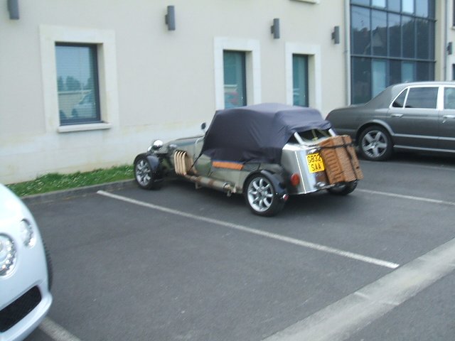

  25. Probably not the look you're after -- Florin's hoop was cut of & fitted with a tow ball -- which in this pic is under the "picnic basket" (Which contains all Florin's needs -oil/water/spares.
