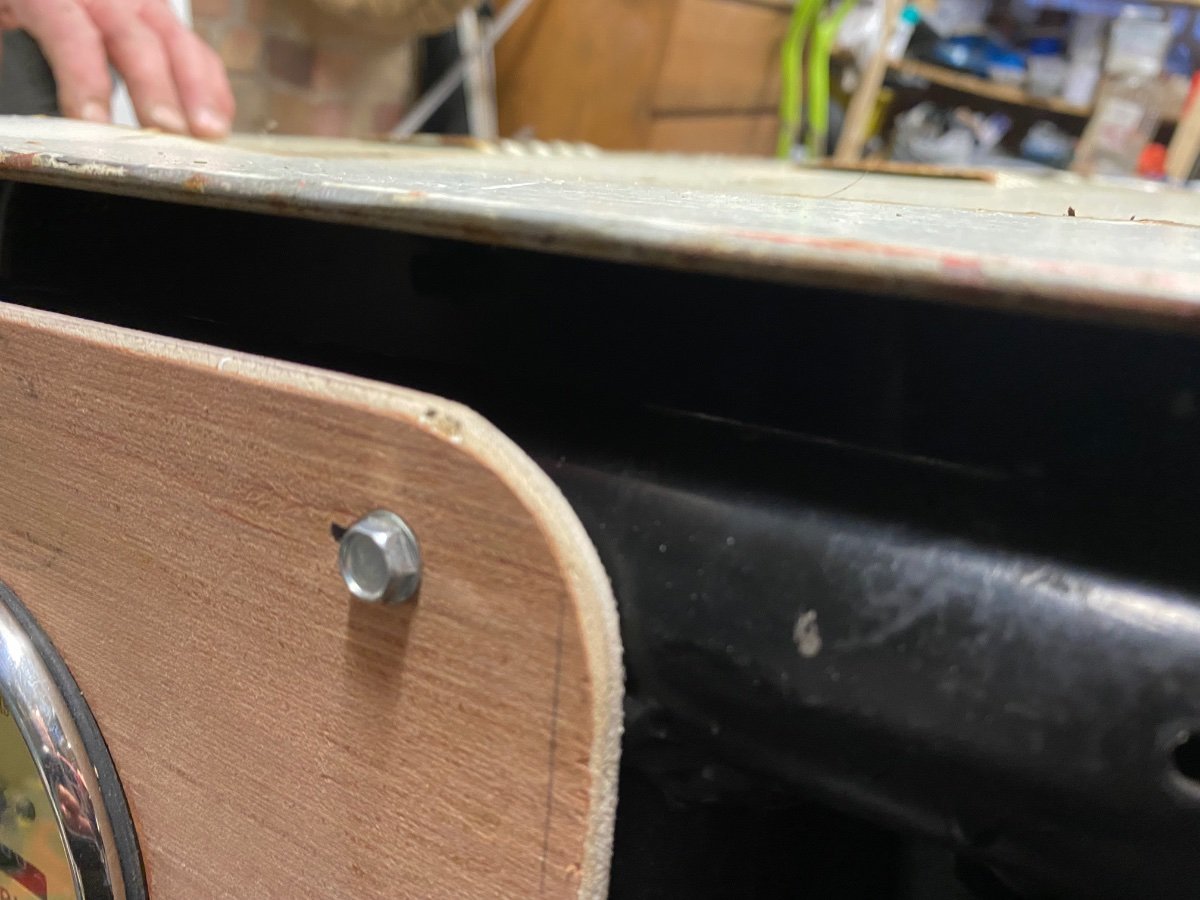

  1. Thank you very much, that looks very good, what is your dash made from

  3. Thanks for your reply we do appreciate it. don't worry about the steering wheel its not in its final position but good point and noted. has you got a picture of a dash that is full length, we would love to see one please.
  4. yes we can do that but what do we do with the rest of the front. the dash is only 40% of the area

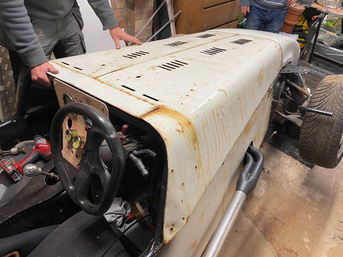

  5. We have offered the bonnet onto the chassie but we have and 25mm gap please see photos. Any suggestions how to fill this gap would be helpful
