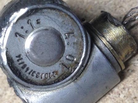

Hi fairly new to this so here goes...my speedo cable is broken and looking to replace - I have taken this picture but was trying to source a new cable. any ideas from there pictures? Thanks in advance for your help!Tim
that looks like a 90 degree drive , that's not a speedo cable.
is it that in the picture that's broken ?

A right angle drive you don't see them very often ( a bit like rocking horse poo). There should be a circlip holding the old cable in. From your photo it looks like the outer has broken and then the inner. Once you get it apart you will need a new cable. I think the standard Sierra one fits the angle drive but if not then it is one from a Granada which had the angle drive.
The drives are available on internet if it has had it, about £120, Just measure length of cable you can get them made up, also on internet, search for speedo cables

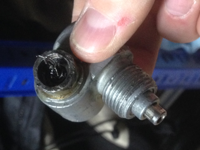

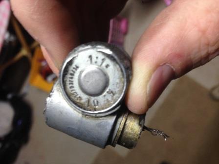

Thanks all, attached brioken section. Where does the c clip go and how do I get the old cable out and new one in?post-13062-0-14249600-1396347029_thumb.jpg
Guest chris brown
From the photo it looks like there is an internal thread so it may screw out. If not try unscrewing the steel bit that the broken cable goes into. I have not seen one that is threaded before.
That looks like the adapter speedy cables used to sell for the type 9 gearbox. Looks like it has been through the mincer. The twisted remains of cable you can see is whats left of a two inch length of square drive cable that goes into the gear box. There would also be a washer on the end of the tube in the picture which goes in to the gearbox hole and is held by a circlip.
Try to remove the remains of the cable. Vice and pliers? Then see if the mechanism still turns. The square 'Nipple' is the output. The remains of the cable the input side. If it still works then you could weld a suitable washer on the input side and find a new drive cable.

We'll tried to remove the remains of the cable with no joy - seems to be spinning freely just need to get old cable out and new one in....
