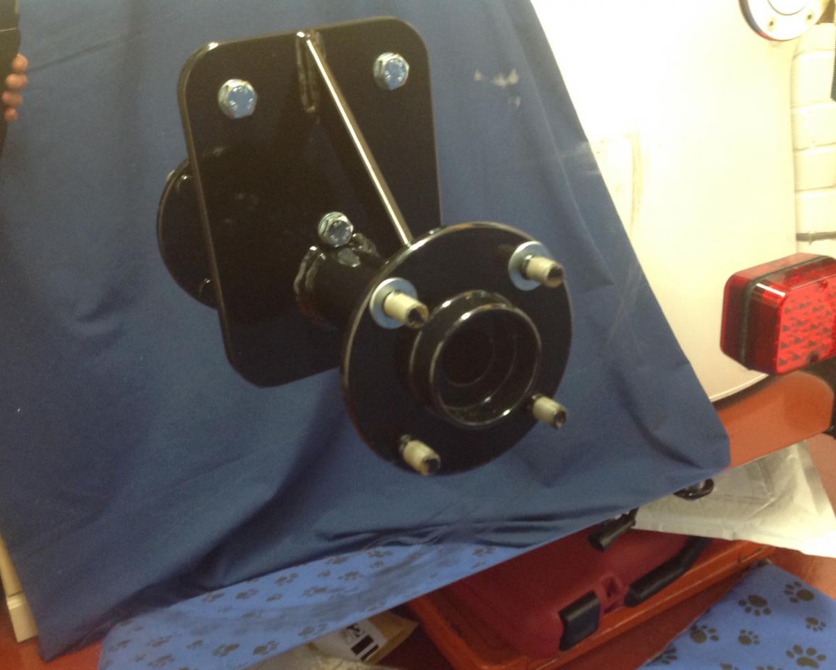

This is what I did to support the spare wheel as the tube is not strong enough. The bracket bolts through reinforcement put behind the rear panel. As per the above post, the tube just holds the number plate
  • Like 2
