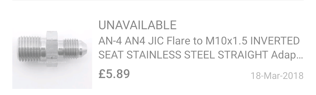

I use these for oil tap into the block and to the turbo. Ether T into the oil pressure gauge hole or about 6 inches towards the back of the engine from the oil pressure switch there's another hole with a grub bolt in it which is the same as the oil pressure switch one, which is what I used
And this into the turbo feed
Nothing else required for oil feed
