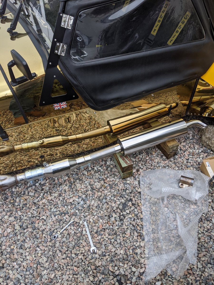

I built my new exhaust for about £150 ( all stainless) and that's with new sports cat that I can fit for MOT and remove afterwards. I also increased exhaust pipe size as the 2" was a little restricted so went up to 2.25" but as yours is a turbo either 2.5" or even 3" would be ok and probably gain a little more oomph 😁
1st pic with cat. 2nd without.
