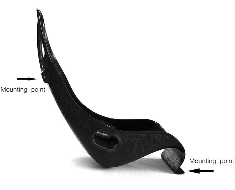

Has anyone bought tillet seats. I have seen http://www.jkcomposites.com/
these look good and do a 41cm wide seat.
I am not the smallest of men and just wondering if anyone has bought these and what the  fit is like for larger man.
