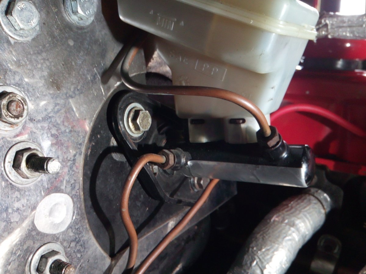

Thanks Foz and Sylvia.  I had tried the brakes without the servo (by disconnecting the vacuum) but found the pressure to be much to hard. I hadn't thought of using a different master cylinder and anyway didn't have any means to determine the one to choose.  It it would be in interesting exercise to find how to mount it to the brake pedal and re-plum the hydraulics and getting rid of the servo would give much more access room under the bonnet.  Could anyone provide details of how the master cylinder is mounted?
I can send you some pictures of mine but my car is a 2B, using a Sierra pedal box, so I'm not sure if it's similar to yours, or not.  I fitted new rear wheel cylinders a few weeks ago and I don't think I've got all the air out so  I want to try bleeding them again later this week.  I can take some photos of the master cylinder while I'm at it, if it will help.

Thanks Steve.  If it's not too much trouble, photos would be useful.  I doubt I will do a conversion for a while if at all,  It will depend on how I get on with the current setup.

I tried to take some photos of my master cylinder today but soon realised it isn't easy to show you anything useful with everything in place !
It bolts through the front of the sierra pedal box, (where the servo was) with a couple of new bolt holes.  I then had to make up a new pushrod and pipe it up.  I have attached a photo of it in position to give you an idea of how it's fitted.
I'm glad you're happy with your set up now and it's probably best not to let me confuse things !
