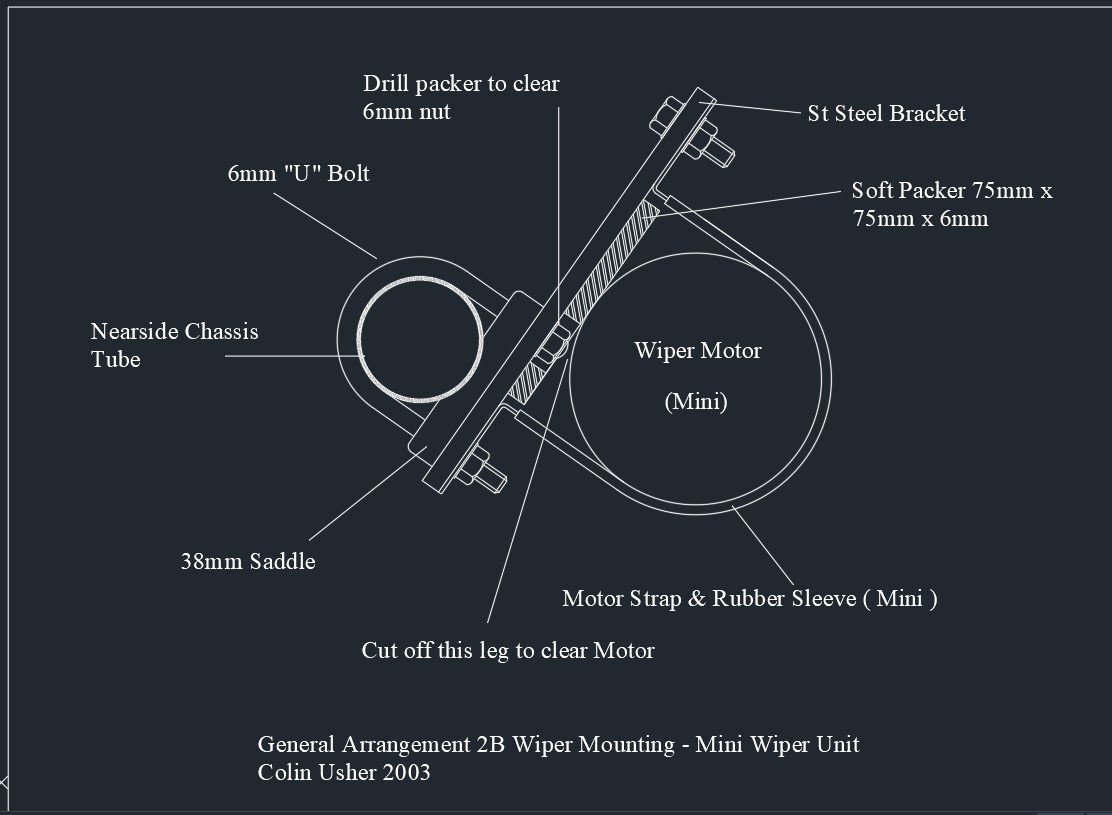

Hi all…… my 2B has a mini wiper motor, like everything when I got the project was fitted sh*t, held on the frame with cable ties when I use the wipers they just shake about everywhere, what’s the best method of securing the motor to the frame, all ideas welcome thanks Shaun
When I fitted the Lucas Mini wiper motor to my Superspec (similar to 2B) I mounted it on the inside of the firewall in the passenger footwell. Used 2 short bolts to hold the U bracket securely to the firewall. It’s at 45degrees so the drive tube curves smoothly up to the spindle gearbox on the scuttle. Has been secure and worked fine for the last 4 years.
