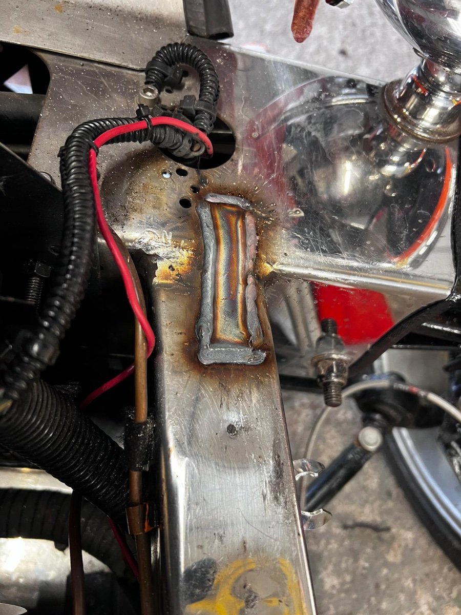

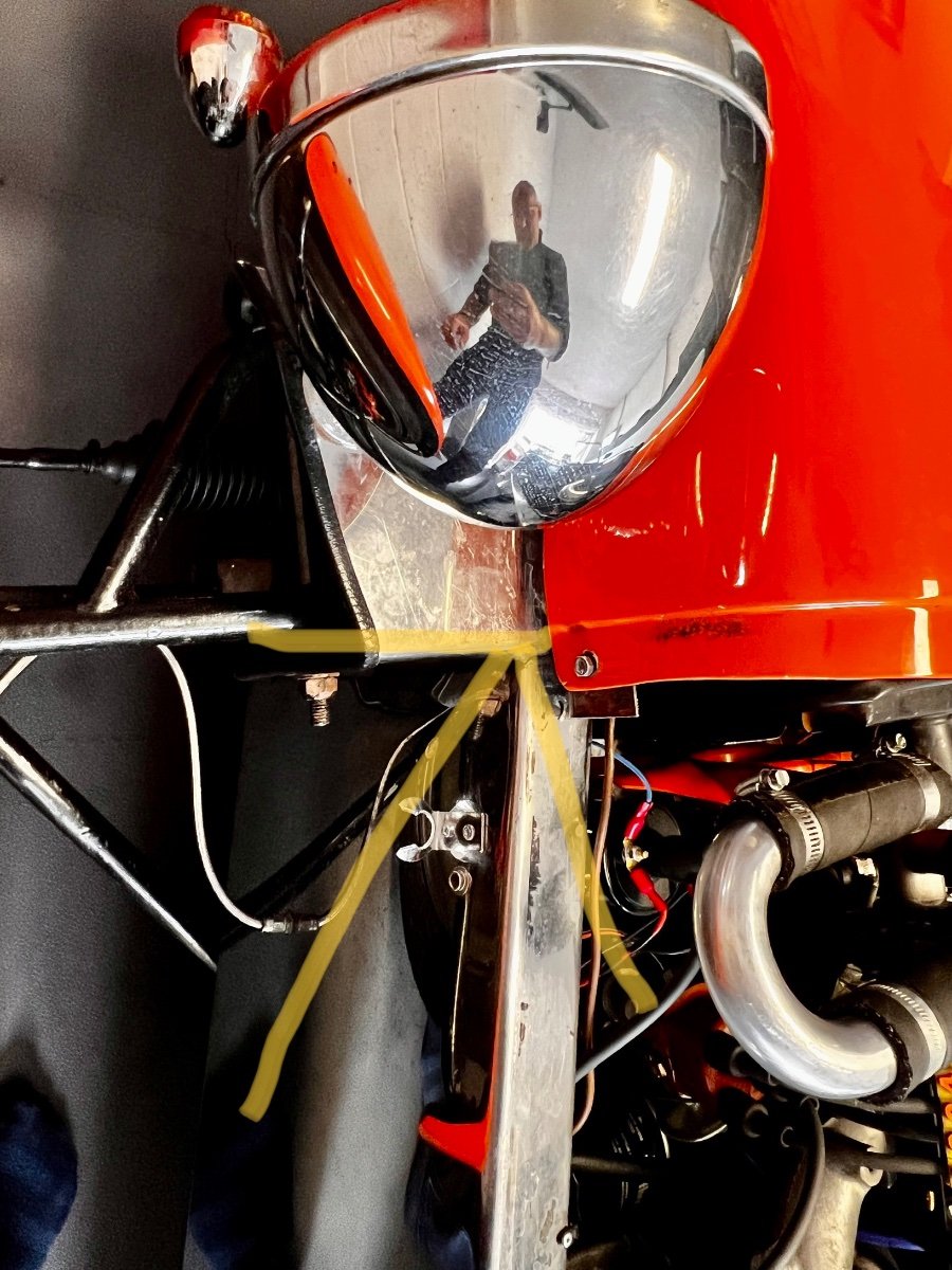

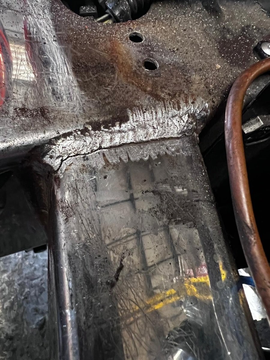

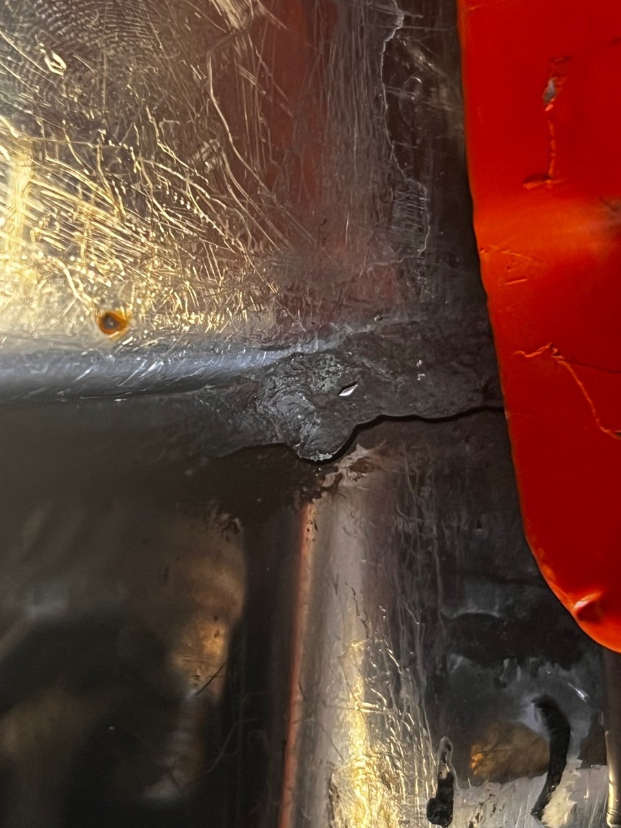

Ok so looking at threads my 3a chassis having cracks in the weld is a pretty common occurrence, I have just noticed these on both sides my question is it just a case of running a new weld down and keep an eye on it or is there a tried and tested way to strengthen up and prevent further failure? IMG_6530.thumb.jpeg.faea0aed351a393450517e3e8799fbd7.jpegIMG_6529.thumb.jpeg.50b95edb624c3c68b6ca633d5da1145b.jpeg
I had this done to mine after 29,000 miles, re-welded and a  patch on the top, has been OK for 9 years and a further 9000 miles.
Thanks for that I was thinking patch over the top nice to know it works well appreciate you taking the time 👍
