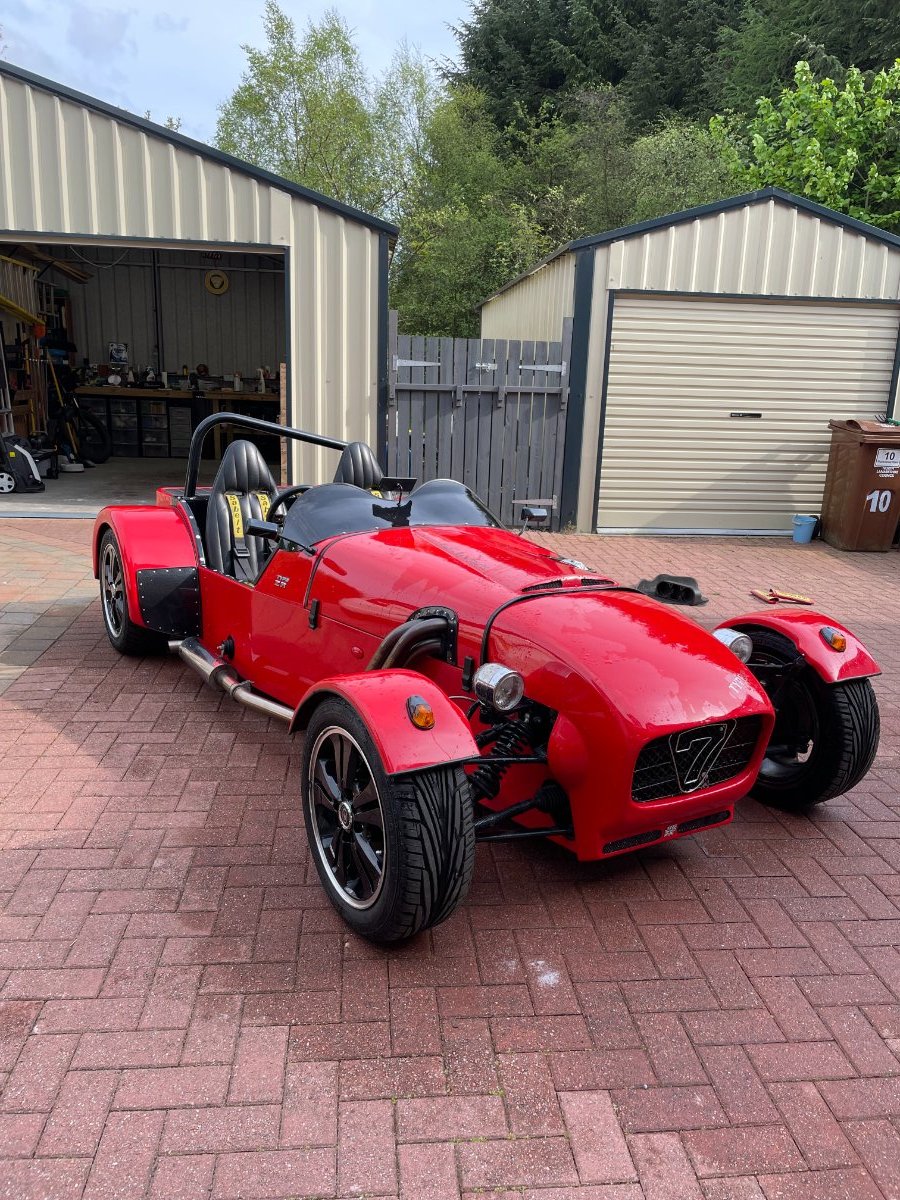

My name is Charlie Garvie, I joined the club last year, but due to work commitments I haven't been active during this time, after receiving my membership renewal recently, it has spurred me in to action and given me a kick start to get my car back on the road. I  took the car for an MOT last year but it failed on excessive play in the steering rack, the garage have tried to source a new rack, but they aren't having any luck I'm afraid so, was looking for some help/advice to source this.
I have a MAC1 type ZR built around 2010 in by MAC#1 Motorsports, Unit 14 Portland Business Park, Handsworth, Sheffield S13 8HS who unfortunately are no longer trading, the donor car was a ford Sierra and on the build schedule they say that they used the rack from the car with some modification but no more info, the garage have tried their usual steering rack provider, they can't identify the rack, all they could tell us was they think the rack has been shortened. I would really appreciate it if anyone could give me any pointers as to where to source a new rack or a company who could refurb, I'm in Glasgow but happy to ship the rack to any part of the country,
