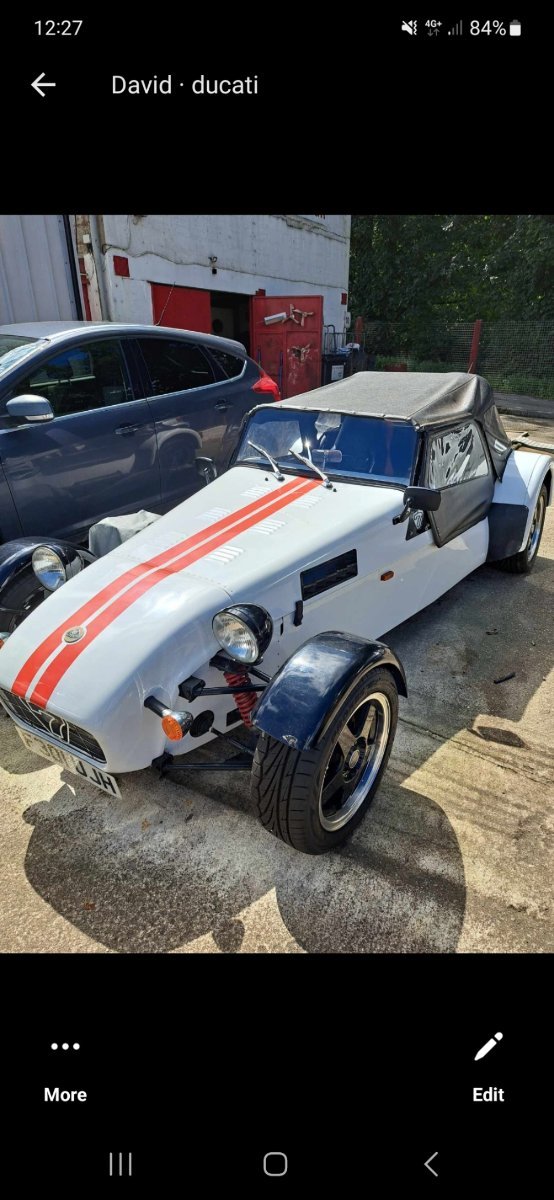

  1. I can't believe I'm writing this but I'm left with no choice but to sell my 2b, ive had some news recently regarding my health which means I'm having to sell all my toys, so it's a 2b correctly registered on log book, runs drives, stops absolutely fine, has mot until September, i have owned it for a year now but only covered around 100 miles, because of weather and a problem with fuel pump (now fixed)mileage is around 5200 miles (backed up by mot history, but the previous owner changed the clocks so is reading around 100 miles, in September last year it had just over £1000 spent getting it running right, charging right etc which I have the receipts for along with a massive folder absolutely stacked with reciepts, build documents etc, I've recently re wired the car, fitted new dash etc, needs wiper motor re fitting and wired up (I don't use it in the rain so took it of when I was re wiring) comes with hood and doors and some spares, it's a 2.0l pinto with twin webbers, type 9 gearbox, it's had a lot of engine work done including a bigger oil pump head work, new pistons, and fr33 cam and a lot of other work by builder, it is extremely quick for a pinto and also has either a welded diff or lsd I'm not too sure, the bonnet could do with being repainted also the rear passenger arch, the rear arches seem to have extensions on which has cracked the paint on the passenger side were the extension joins, I was intending to paint the whole car but now for obvious reasons that's not possible, ive just fitted a expansion bottle because it runs a bit hot (around 95-97°c) but does have an electric fan I've just fitted new carpet too, does need a hazard switch as the one on the stalks constantly flashed so i stuck it down, this is a great fun car and I had big plans for it but unfortunately life sometimes throws curve balls that can't be caught,I'm looking for £4500ovno and thought I would offer it here first before dealing with the Facebook scammers, tyre kickers and just general dreamers Facebook provides, car is located in east sussex, feel free to come and view anytime, it's located on an army Base in a hanger so there's land for test drives etc too. I'm going to stay a paid member of the club for as long as I am around if that's OK, it's a great club full of knowledge and great people

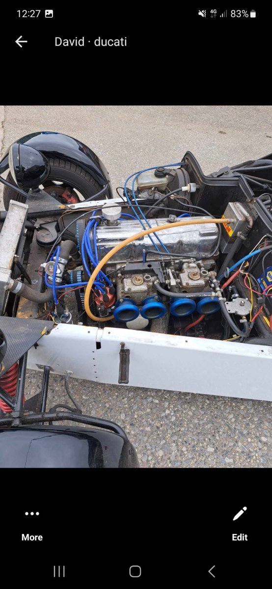

  15. Thanks Bob, unfortunately I know nothing about the engine as it was in the car when I brought it, all I know is twin webbers unsure if 40s 45s or another, I know the heads been skimmed and ported but unsure about much else, here's a picture of the carbs, maybe that'll shed some light as to what carbs they actually are

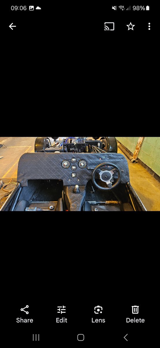

  20. So though I would give a quick update, here's the before and midway pictures, and a picture of what i have removed, must have gained 5hp in weight reduction, haven't taken a picture of the finished job yet, but new carpet is in, ive covered the back upright in diamond stitch faux leather, when seats go in tomorrow I'll update
