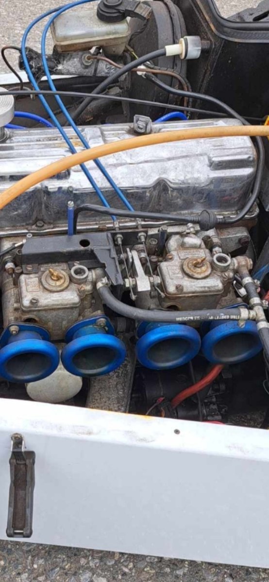

Thanks Bob, unfortunately I know nothing about the engine as it was in the car when I brought it, all I know is twin webbers unsure if 40s 45s or another, I know the heads been skimmed and ported but unsure about much else, here's a picture of the carbs, maybe that'll shed some light as to what carbs they actually are
Weber DCOEs I think. I cant tell the size. As for power, I'd estimate anything from 125 to 135 depending on head work and exhaust system.
