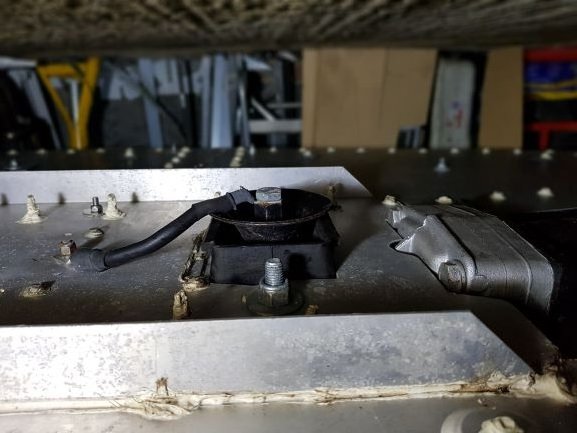

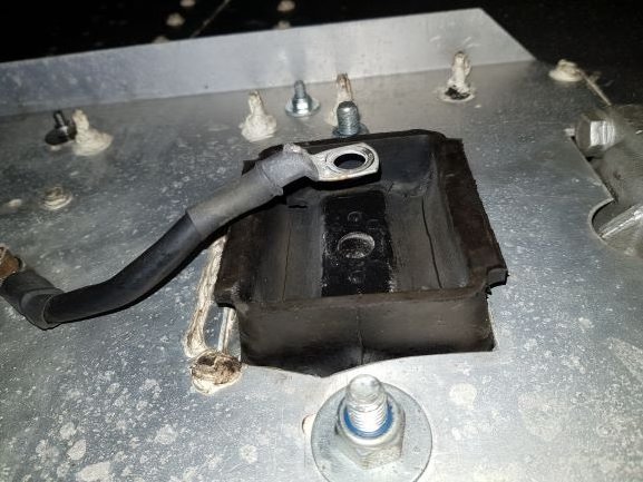

  3. I have my gearbox out at the moment, as I'm going for a rebuild and higher 1st gear. Anyway, it made me think about the rear mounting point, which I know is the lowest point on the car after going over speed bumps! I kept it as on the Sierra, where a bolt with a long hexagonal end goes through a bell-shaped "washer", then the earth strap is screwed to the end of this hexagon. My question is why the need for this bell-shaped washer? Can't you just leave that off and put an ordinary set screw through the earth strap ring terminal and on into the gearbox? This would significantly raise the lowest point on the car, while still mounting the gearbox and creating an earth... Pete
