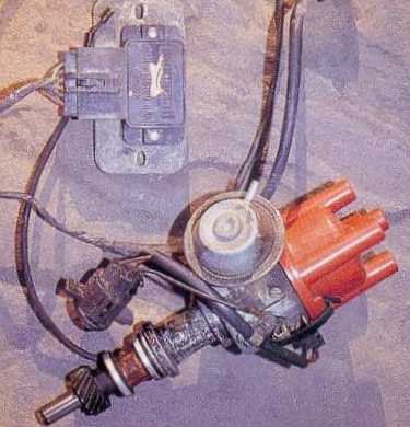

Having real trouble interpreting the wiring up of Motorcraft IGN module for a 1983 2.0 Pinto SOHC.
This is from scratch, no existing loom, with the Bosch 3 wire inductive dizzy. Orange and violet leads plus black earth as per pic attached.

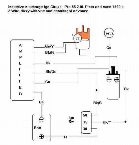

I found your reply to a post on this issue with helpful options on wiring diagram (attached) Could you please confirm that the diagram is as viewed from above with connections going from 1. on the left with the Brown lead to battery Neg. Across to 6 on the right with the two wires from the dizzy, black and red at no 5 and green and yellow at no 6. Do you know which please is the orange and which is the Violet at 5 & 6?
Having trawled the internet for the correct wiring up of this module, there is a lot of conflicting advice. As yours seems to be the most helpful found to date, I hope you do not mind me asking for your assistance in this way.
