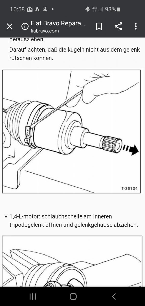

  12. OK, I try to explain. If you want to replace the bellow, you must open the black parts you see on the link, I've postet. These parts, I don't know the englisch name, so I call them Bell, are on this side which you stuck the drive shaft into the rear axle differantial and the wheel hub crimbed to the toothed axle. So if you want to disconect the tripod bearing spider wich is inside, you must open the flare and pull the bell down. then you can disconnect the tripod, pull the Bell and the bellow from the axle and replace the bellow with the new one. Now you have to replace the Bell too, but you never get the flaning so good as the original one. Also you have to replace the bell too. And here is the problem: I can't get a new Bell. So I look for a new drive shaft, I hope i described the problem well
  13. Here is an picture complete drve shaft. The "Bell" are the black Parts at the end. drive shaft
  14. Thank you Martin, but this is one part of the Problem. I get those bellows. but there is an other part you must replace. It looks like a Bell and is crimped on top. The bellow is on the foot of this "bell". To change the bellow, you must open the flanging, disconnect the Tripod, then you can replace the bellow. That's the Problem. I can't get this "Bell".
