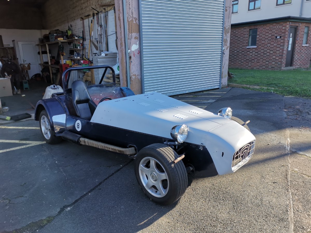

  9. A long break due to house move and running my business with projects where I’ve pretty much lived away for the last year I’ve now finally got back into it got my new wheels fitted
  10. Offered up new wheels, need a bigger spacer for sure to clear suspension, now waiting for graphics to come and started fitting parts back on, hopefully 2 more weeks to complete and the I'll be sitting in it ready till restrictions lift

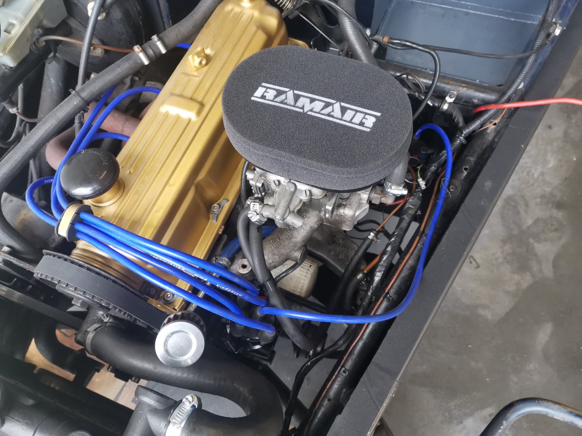

  18. https://ramair-filters.co.uk/rs2-215-401-ramair-carb-air-filters-with-baseplate-weber-32-34-dft-25mm-bolt-on/?utm_source=sando&utm_campaign=sando-p1 Prob ebay too I'm at RAF Coltishall so not too far, will be good to get all in this area together once allowed as some great roads especially coast road
  19. Ramair do a filter to fit that carb, I did a fair amount of research and pros and cons to a foam filter or k&n style pancake, these came up well, 45mm sits nicely under with clearance.

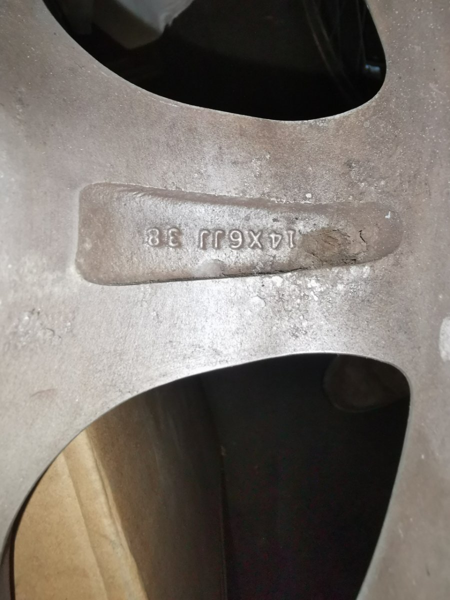

  23. Thank you Ian, happy with that spec then, really appreciate that level of understanding. Am I right in thinking jj corresponds to a 4x4 wheel, mine looks not too different from the standard ones given out for the kits?
  24. As increasing the car’s wheel rim diameter by 1 inch means I need to increase the tyre section width by 10mm and decrease the tyre aspect ratio by 10 points?
  25. Hi All, please forgive me for being a simpleton, however I would like to get a understanding on total rolling circumference and alloys/tyre size I wish to purchase new alloys and tyres for my 2b, currently on it are 14 x 6jj 38. Tyres 185/60r/14 So 14's with et 38 4 stud, is pcd 4x108? I wish to get a set of 15'as carbon huggers to go accommodate 15's and better tyre choice, at the moment there is a few mm spacer on also, can people please confirm I could purchase a set of 15 x 6.5 or does it have to be a 6 j Tyres look mostly in 195/50/15 Is this the right size or what should I be looking for? Chris
