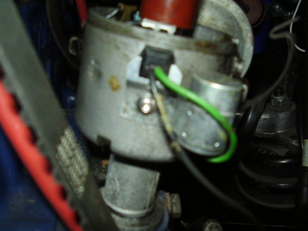

cheers everyone, There is a brown wire inside the dizy that looks like it connects to the dizzy casing (potentially earthing thru the block??) Sounds as tho it is a nice and simple circuit (but to counteract that i am a bit simple too). I have already wired in the dash instruments onto the multiplin plug from my sierra and the ignition into the VG loom as per VG instruction sheet. So if i connect the VG loom black & blk/White wires to the coil terminals and run a wire direct from coil -ve to the dizzy will VG take care of the revs & ignition and is bob still my uncle?
not sure where that leaves me now? Where does the 1 black wire from the dizzy connect to if not to the amp? What do i do with the 2 dizzy wires out of the amp?

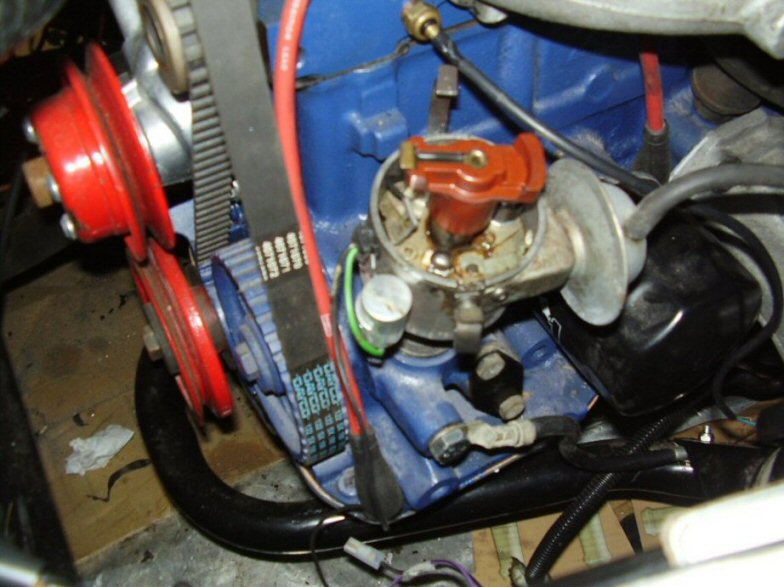

I am starting to feel like a dependant now with the amount of questions i have posted lately. I have the simple ingnition circuit (6 wires) from the motorcraft amplifier onto a 2.0l pinto and according to the haynes manual, 2 wires go to the dizzy however.... the dizzy i have only has a connection for 1 wire. From the dizzy there is one black wire with a connector and a green wire that goes to a capacitor type thing on the side of the dizzy (with no connector on it). Beyond these the are no obvious connction points/terminals. This is the dizzy i have, Any ideas what to do with the other dizzy wire from the amplifier? you will also have to speak slowly, as to me dizzy is what happens when you spin around and fall over.
