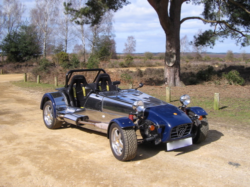

We dusted the cobwebs off the 2B this morning and took it for its first drive since January. We went out into the New Forest around Beaulieu - there's a nice mix of long straights and tight twisty bits. Pity that the speed limit is 40 but I suppose it reduces the risk of hitting a wild horse! There was a scary moment when a motorbike decided to overtake us whilst doing a wheelie just before a blind bend
. I don't know who was more suprised - me or his pillion passenger! Anyway, here's a picture from a little car park by the side of the road.
A few people came over to have a chat - one guy was thinking of building a kit car but his wife didn't seem quite so keen.
Who else was out enjoying the good weather?

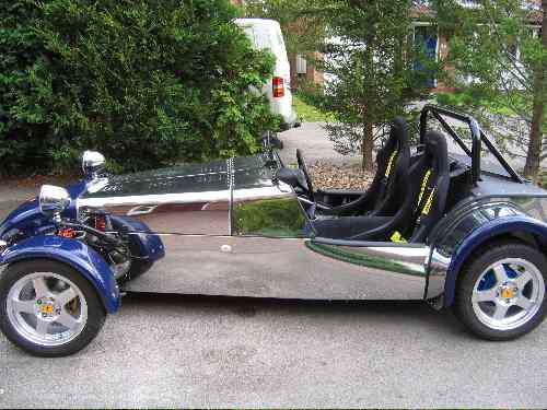

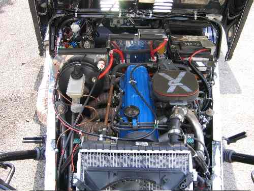

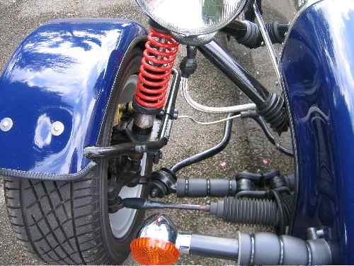

I took the car for an MOT today which it passed. The mechanics at the garage were very professional and helpful (and the service was very good value). In addition to the MOT, they set the headlight aim, adjusted the timing and mixture to improve the emissions and set the tracking to 1.5 degrees toe-in. It now has perfect self-centering and sounds much better than before. The only things they pointed out were a very small amount of oil leaking from the fuel pump and the brake servo vacuum hose is not rigid. They recommended that the fuel pump be replaced reasonably soon but it isn't a major problem yet.
As for the vacuum hose, it is Samco reinforced flexible silicone vacuum tubing. The mechanic said that since it can be blocked by squeezing it, the SVA examiner might not like it. Has anybody had a problem with similar tubing at SVA?
I've attached a few photos of the car below. I would be very grateful for any suggestions / criticisms if you spot anything wrong. I know that the track rods need covering (I'll cover them like the track control arm and indicator extension) - I left them accessible for the tracking adjustment. Thanks! All the best,
