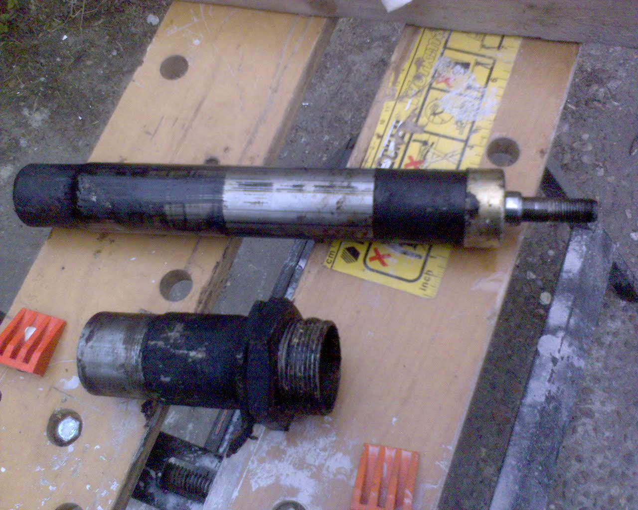

Probably sorted now but I have just found some photos of the suspension set up on my Exmo.
this is the (leaking) P100 strut insert with the collar removed.
