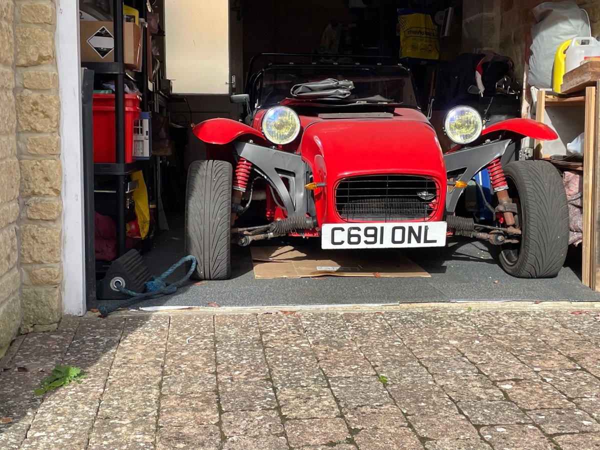

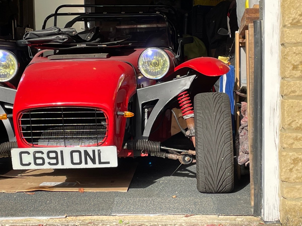

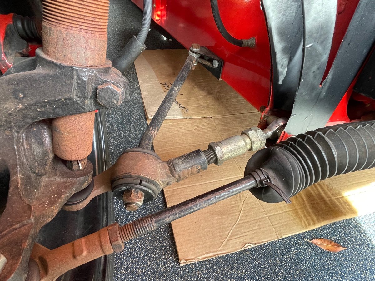

    My tie bars are adjustable. I’ve got a threaded rose joint that allowed the tie bar to be lengthened or shortened, this allows the TCA and suspension to work together.

    No problem. I’ll try and get a picture later so you can see the end result.
  5. Dave Ed
    Exmo TCA mod
    Sparepart. As I moved the distance of the wheel outwards I had to be careful of the clearance of the suspension in the buttress. There’s not a lot of room for manoeuvring so there is no adjustment of caster as far as I’m concerned. Camber adjustment is obviously by the TCA and by moving the base of the wheel out it actually aligns the suspension strut to a slightly better angle. I do need to get a better solution for this though and I have some floating bearing top mounts from an escort that needs machining that should sort this eventually. Self centering seems quite positive but I need to play with it slightly as my suspension is set way too hard and this could improve it later on. One thing to note however, was that I had to enlarge the TCA mounting hole on the chassis so once I’d done that, there was no going back.

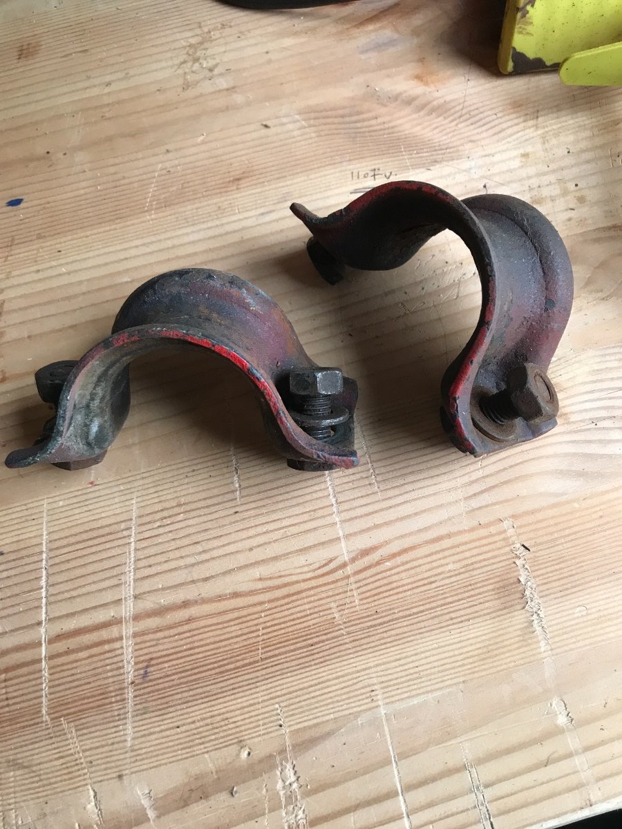

  10. Here’s some pics of mine. Underside and from above. Hopefully they make sense and give a degree of fitment. Dave

  15. Are these what you’re looking for ?
