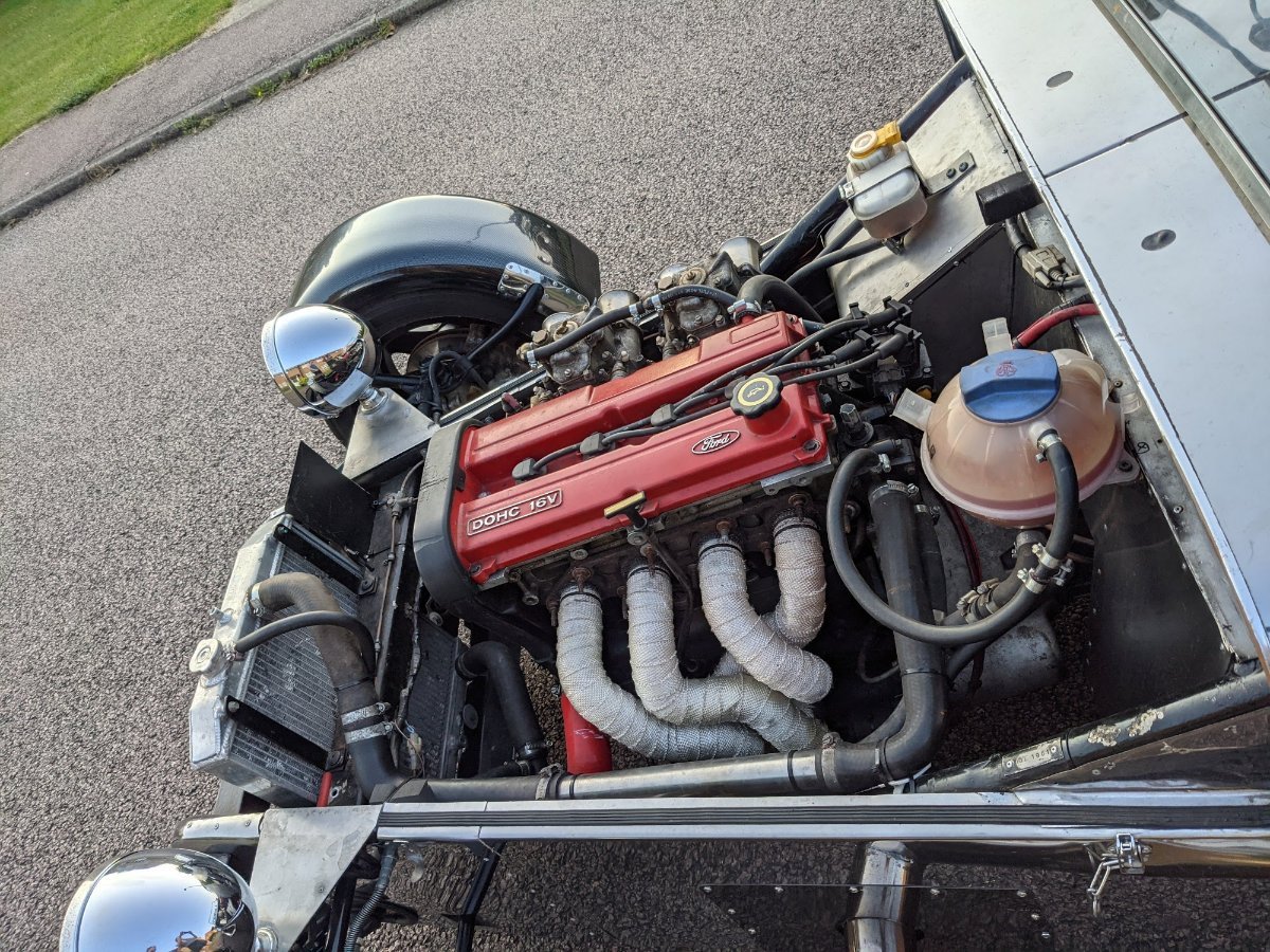

  2. Yay it lives again. Summary after the last couple of weekends. Weekend 1: compression test - aborted. Zetec needs an adapter in order to get the cheaper testers deep in the engine. Note for others, example adapter https://www.lawson-his.co.uk/sealey-vs200-a-long-reach-compression-tester-adaptor-zetec poked around a lot more. sparkplugs were getting wet and some fuel visible in the carbs, less so on 3/4 but still fuel getting there. some garbage in the carb fuel filters, but nothing too much? anyway, cleaned it out Weekend 2: compression test, all looks good. Dry, the 4 cylinders were 124, 125, 124, 124. Didn't bother with a wet test as this was normal AFAICT. took the carbs apart and cleaned out everything I could using carb cleaner spray, and without disassembling anything that would result in me needing to re-tune them. After cleaning and re-assembly I manually put a few tablespoons of fuel in the reservoir in the carbs under the floats - and SHE STARTED decided to therefor look a lot more into the fuel system. worked our how many L/min it should be for my fuel pump (3.5psi), disconnected the carb end and turned it on to see the flow rate. Hmm, about 20% what it should be and kind of irregular. took the fuel pump off, not much to look at (it was a https://www.osiaspart.com/OSIAS-inline-diesel-fuel-pump) but evidently it wasn't working well. Checked the lines were otherwise clear Weekend 3: replaced the fuel pump with a new one of the same pressure (this model but from ebay https://www.racetep.com/manufacturer/carbs-and-injection/weber/electric-fuel-pumps/lower-cost-singe-carb-pump.html), and also replaced the fuel hose for higher quality stuff for the new gas. New fuel pump has a fuel filter (the last setup didnt have one...). Upon starting the new fuel pump I noticed now the fuel union was leaking fuel with the new pump, so much so I didnt want to catch fire, aborted and went home. Weekend 4: Installed the new seals I ordered https://classiccarbs.co.uk/product/weber-dcoedcospdcom-twin-carbs-fuel-union-inner-fibre-seal STARTED FIRST TIME So, TLDR; fuel pump blocked/failed/died and then a lot of tail chasing as I worked out what was going on. Probbably for the best as at least the new everything will handle E gas better.
