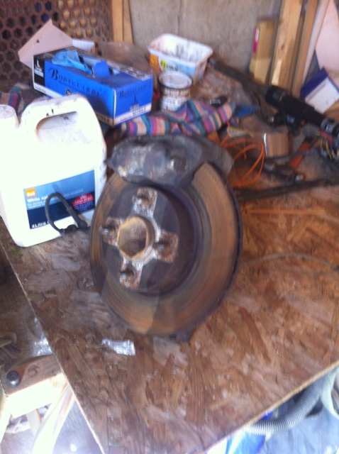

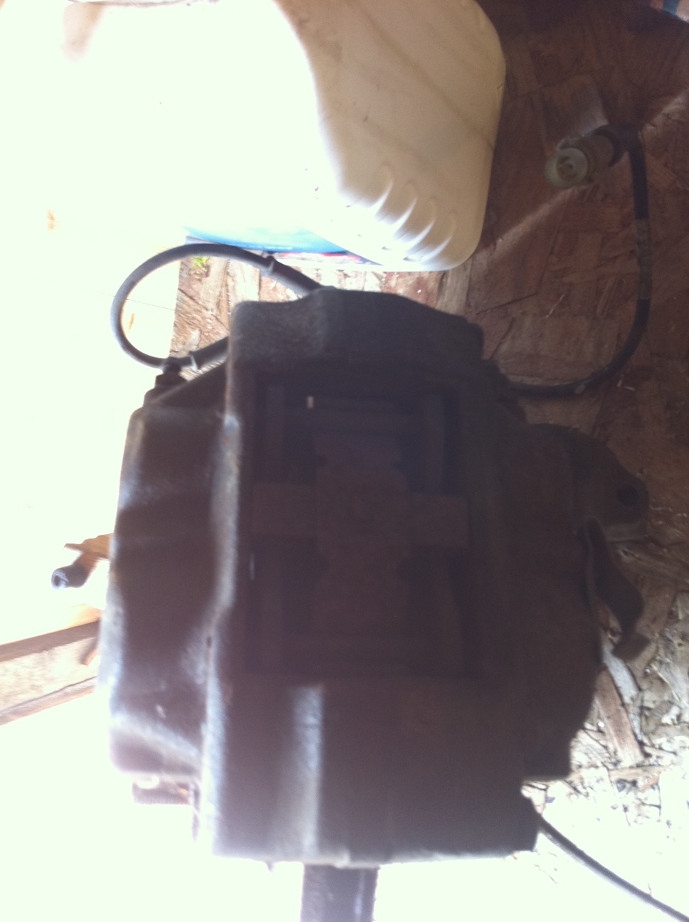

i have just brought some front hubs for the zero, when i went and picked them up i saw they were cosworth ones with the 4 pot brakes on them, i was very pleased with these as i had been intenending to upgrade to 4 pots once on the road.
its only after a few days of thinking about them that i realise ive not really heard of many people fitting these hubs and have started to worry that there may be a reason for this lol,
so is there any reason not to fit them or do they not fit ? have i brought something i cant use ?

Just make sure that the wheels you intend to use will fit over the calipers.

Thanks that's just what I wanted to hear :) I will try one of the wheels off my fiesta to see if 15s will fit over the brakes
Thanks for the advice Tom
