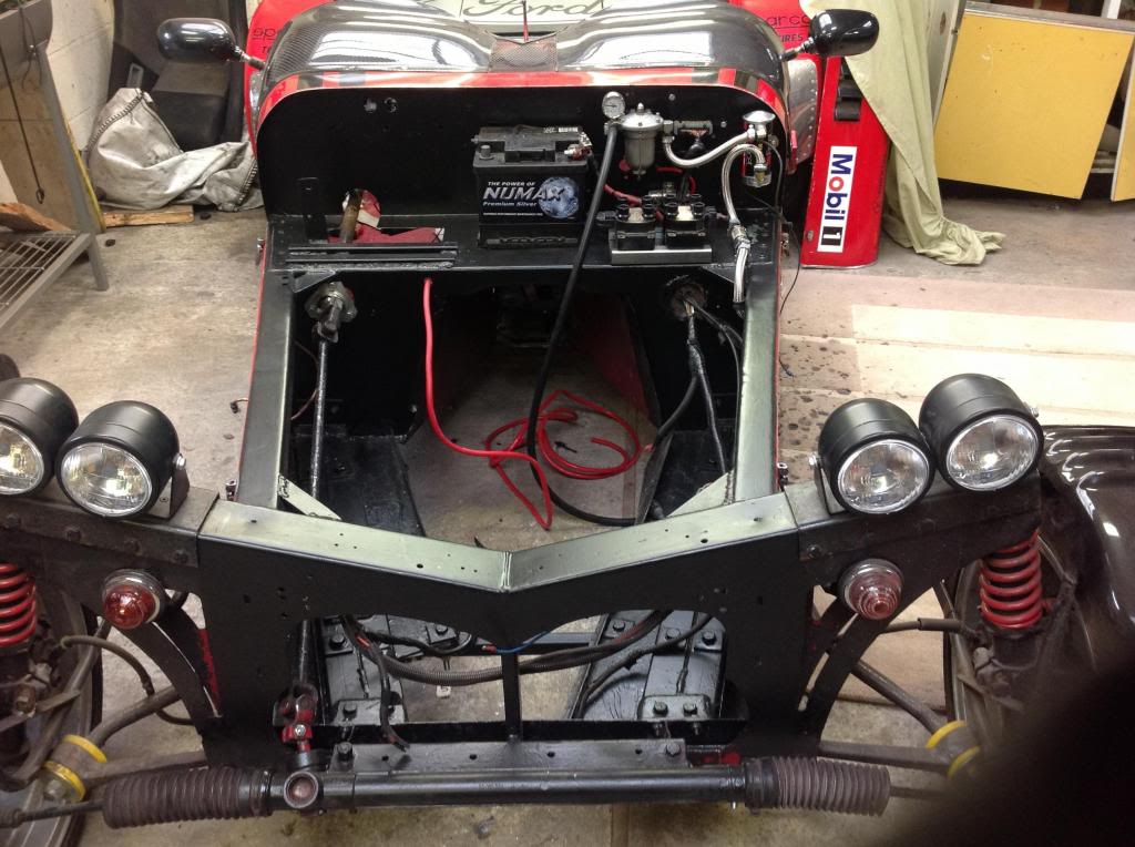

It's certainly isnt easy but its doable ,I took the master cyl off [ braided pipes] and found the guy who built my car had mounted the bearing on a seperate plate bolted to the bulkhead makes life much simpler mower man :crazy:
This is how I did mine:
4 bolts through the bulkhead:
Bearing on plate with bearing bolt heads welded to plate:
Mounted from inside foot well:
All nuts tightened with steering column is situ.
Hope this gives you some help.
Nigel.
