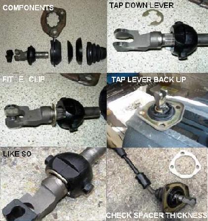

Simple way is to space up the lever with 3 loose nuts and push lever down through the bearing, makes a difference but not a great deal as type9 change is pretty good and we cut down the lever anyway

Did some pics a while back. Took a lever apart to show the parts but don't take yours apart. It's a destructive process. I used a cheap plastic kitchen chopping board for the spacer. Inserting one E clip gives a good action for me. You could insert two or three depending on thickness of mounting spacer and feel of the result. One important point. Measure the change in position of the ball on the lever and make sure the spacer is the same measured thickness. This keeps the end of the gear fork/saddle in the same relative position on the selector shaft.

most available short shifts make the shift too short and make the shift very notchy. In any case it is more satisfying to make your own.
