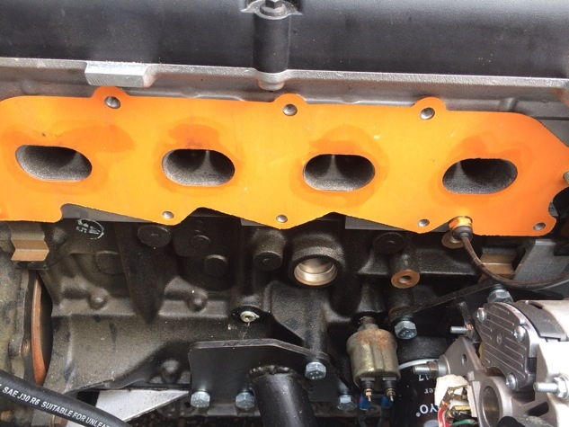

Also to say my inlet manifold isn't flat would be an understatement! Maybe upto 1mm out with two different flat edges to check. Pic shows the gasket, I thought that was a clear sign of an air leak but maybe it's just where fuel has soaked down? What do you think?
